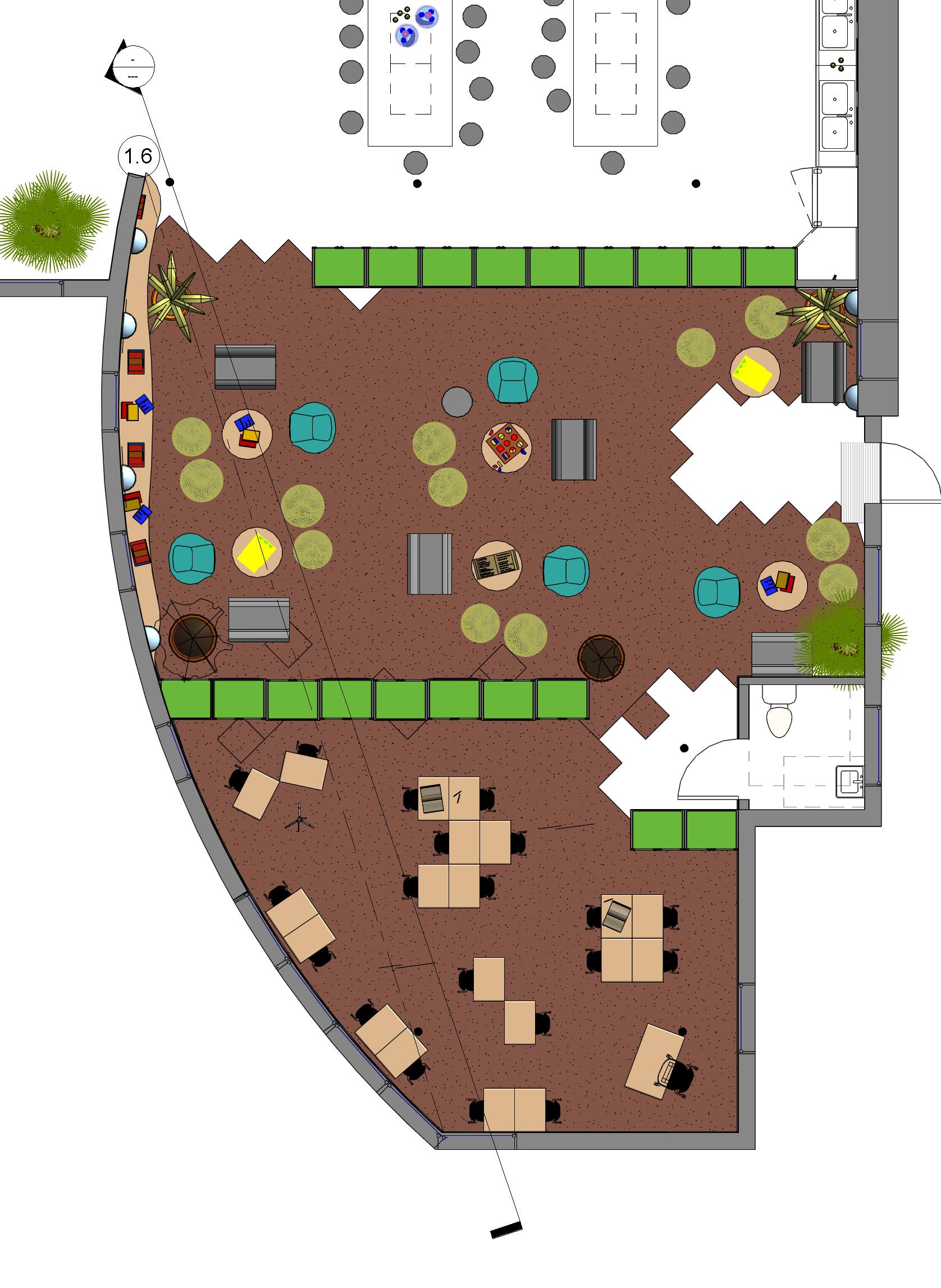

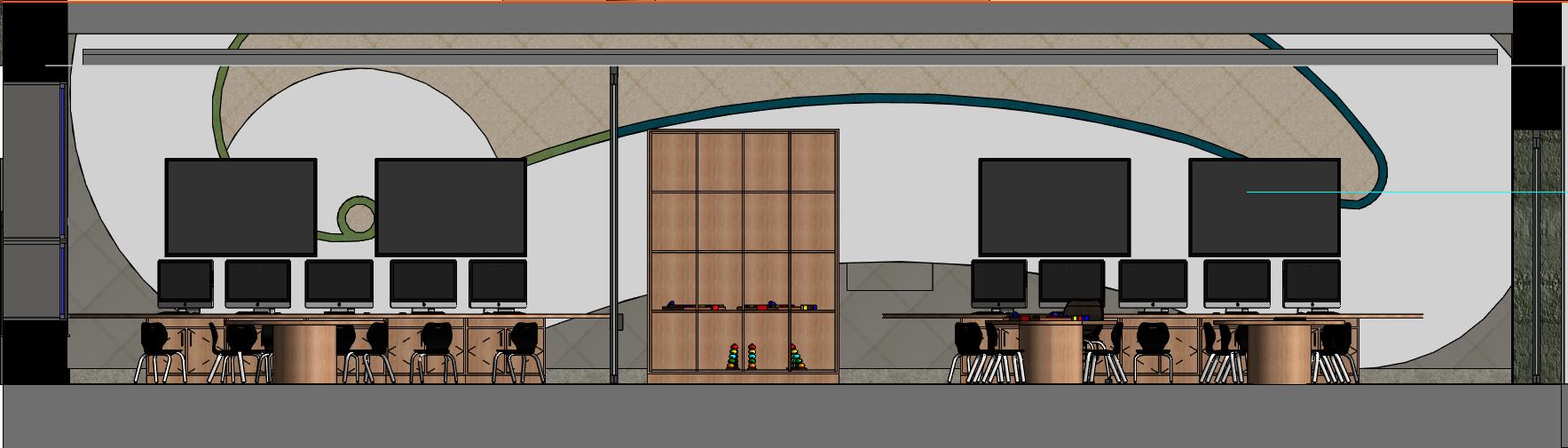

I want to create a wall design like the one shown in the attached section on the curved wall shown on the left in the attached plan.  The wall design uses four separate finishes.
Many thanks in advance for any advice you might be able to offer!
-P

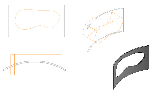

I hope this helps:

Yes, you need a workplane to draw the curvy void from an elevation view. The workplane can be a grid line that you have previously created at the floor plan, paralel to the elevation from where you create the void. Then, from that elevation, start a void extrusion. Revit will ask for workplane, then select from the pull down the name of the grid line that you created. For detailed info about working with voids and solids and Cut Geometry, please refer to Wikihelp at:
http://wikihelp.autodesk.com/Revit/enu/2014/Help/0001-Revit_Us1/2854-Tools_an2854/2855-Sketchin2855/2879-Creating2879

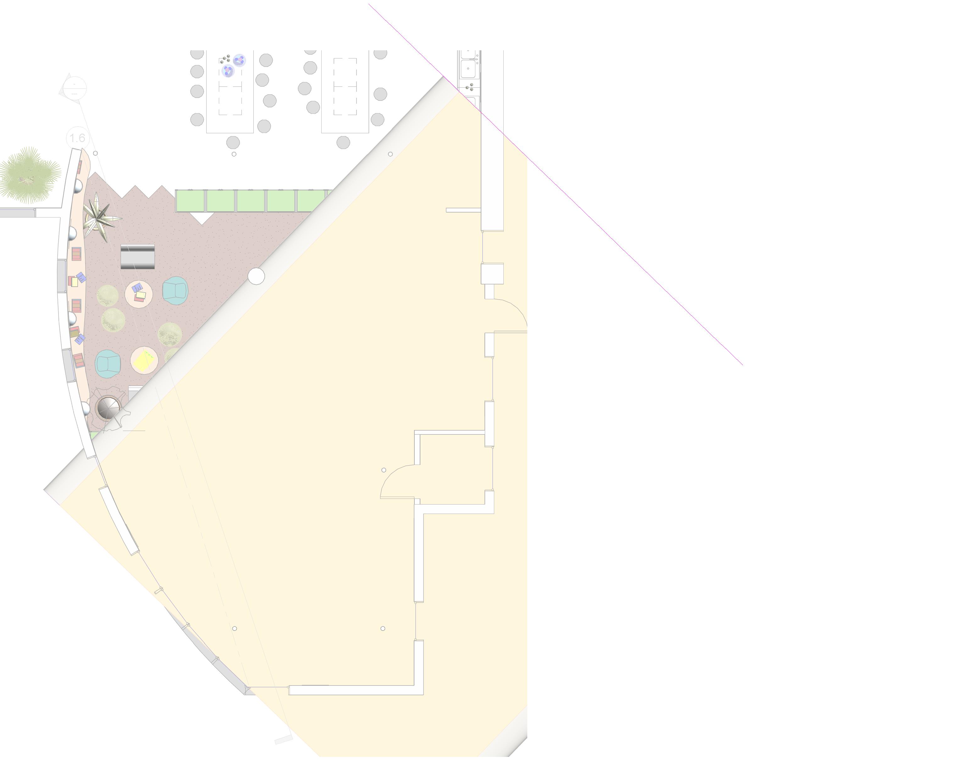

Thank you, I am trying to do this.  Here is what I did:
1. Draw grid line in plan view joining the edges of my curve in a straight line (grid 1.6 in attached image)
2. Massing & Site -> In-Place Mass
3. Work Plane -> Set,  Name {Using Gridline I just made}
 Which takes me to a section view I made just in front of the gridline in which I do not see a void form, but I keep going
4. Draw -> Curve tool.  I try to draw on the wall to make my curvy void and it kicks up an error saying "None of the created elements are visible in Section: Section 22 View. You may want to check the active view, its Parameters, and Visibility settings."
Where have I gone wrong?
Sat, Apr 6, 2013 at 7:49:19 PM | Serpentine Curved wall
#12
phebew
Joined: Mon, Feb 6, 2012
10 Posts
This is where my mass/void is being drawn, when I draw on the reference plane shown in that section view.  ???
