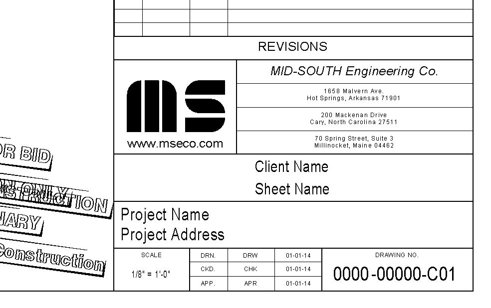

I am finalizing some construction documents at my firm and I am making custom titleblocks for this set.  The company I am doing this for is very large and has us go off of there template, but the problem is that the titleblock has a lot of labels that aren't already in Revit.  I am trying to figure out how to make custom labels for the titleblocks, but ones that are custom to each individual sheet.  I have made some already, but when I change them on one sheet, they are mirrored across all the others.  I need to make labels that don't mirror to all other sheets.  I need to make ones that are instance ones that can be different on each individual sheet.

Can text be put in the template and edited in each individual project?  I am creating the titleblock template for this compnay and we have many more projects to come with them so we want to create a titleblock template that can be the same in each project.  Don't want to have to have to put text in all of these sheets and line them up all the same... We have about 80 different spots in the sheet that are like this... The company is a very large multinational corporation

ok reading you post on title blocks i have 1 question.....
in the lower area of my title block we have 3 different dates to enter.
drafter start date, ckecked date & approved date.
how can i have more dates added to the title bloock?

I was wondering, what if I want to create a list in my titleblock? I know there are some schedules that allow to put a list with the date of revision and issue, but I can't make it work. Besides, we don't put all the dates of last revision, we only put them before sending them out, and in the number of revision, we use letters and numbers mixed (don't know why).
So, it would be great if I could only put a "Rev.#", a "Date" and a "Issue" copied several times in one same titleblock but allowing me to write different things in each one. Is this possible?
