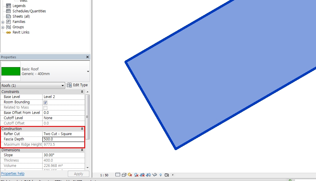

Is there a way to cut the rafter so that it is perpendicular to the roof slope instead of the ground plane?  In other words, the fascia in elevation will not appear straight up and down, but angled to the roof line?  I tried the Rafter Cut under properties, but I don't see the option I'm looking for.

see the attatched image
