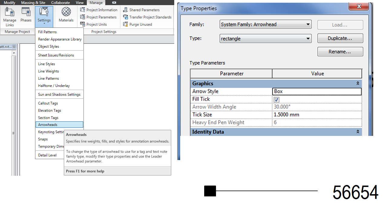

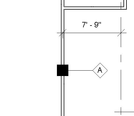

at the end of a leader. This is for a wall tag. the closest i can get is a square, but to match the firms autocad standards it needs to be a rectangle. (in cad its just a pline with thickness thats a continuation of the leader) see image.

You can set up a box arrow style.
Thu, Mar 11, 2010 at 3:28:27 PM | Possible to Developing or Edit an Arrowhead?
pepsiqueen
pepsiqueen Avatar
Joined: Thu, Feb 17, 2005
136 Posts
yes, thats how i got the filled box in the image i posted earlier. however i need a rectangle, and the box only allows for a square.

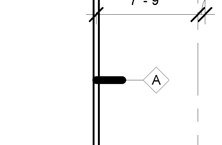

Try a Heavy End Tick Mark. It won't be a perfect rectangle, but it might be close enough to what you are looking for.

well, its sort of OK, except you can't align the tick mark centered over the wall; it attaches to one side or the other. and because the ends are rounded i think i like the square better.
