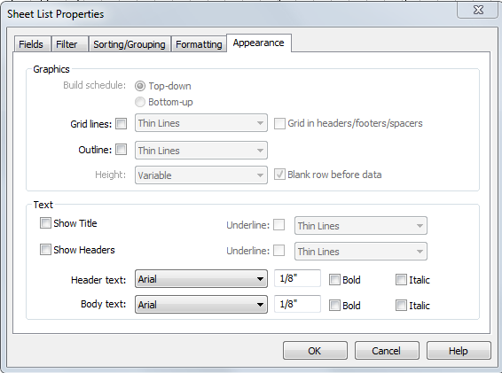

I am new to Revit and kind of learning it as I go.  The firm I am at would like to see the issued boxes inside the sheet index to be larger than what they currently are (see image . . . we want the small black box after the sheet name to be larger)
Is there a properties or parameters area of the sheet index where I can change this?
Second question . . . we would like the index to be a fulling closed box, and currently there is an opening in the box on the line that says Rail Shed in the image.  To close things off we just draw a line in on either side.  Is there a way to close this gap through the settings/properties/parameters?

Here you go:
The only settings you have for schedules are in under the appearance tab of the schedule properties - see attached.  That's it!
If you don't want this, then you can turn off grid lines and add what ever you want on the sheet - but it will not adjust or move with your schedule.

Well that was just too easy . . . worked perfect for filling in that border.  Thanks!
So, what about the solid black boxes that indicate which sheets are being issues?  Any ideas for that?
