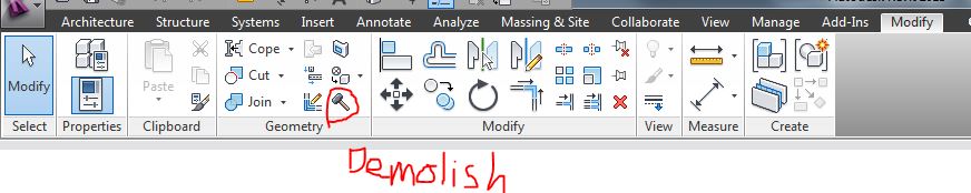

I do use this technique, but I guess what I am looking for is instead of creating from existing geometry, actually showing an existing wall as demolished in a 2d plan. In CAD you would use layers, but I am not seeing anyway to show this in Revit. For example, doing an addition to a building drawn in cad, but drawing the addition in Revit, and showing the changes that need to be made on the expandable end wall. I am guessing this just needs drawn out using detail lines.
"The road to success is always under construction"
Tue, Mar 19, 2013 at 10:57:43 AM | CAD to Revit
teafoe5
teafoe5 Avatar
Joined: Fri, Nov 12, 2010
1749 Posts
4 Stars: 47 Votes
There is a Demolish tool that will demo whatever you want.  You need to set up phasing in your project so you can have an existing/demo plan and a new plan.
Tue, Mar 19, 2013 at 10:59:22 AM | CAD to Revit
Revit is far superior to what you ever did in CAD.  You need to read you HELP on phases.  How to set and use them.  You will learn how to set your views up to show each phase.  Then after you create a wall in existing phase, you can demo it and it will show correctly in a view set to show existing and demolished.  MO LINEWORK NEEDED!

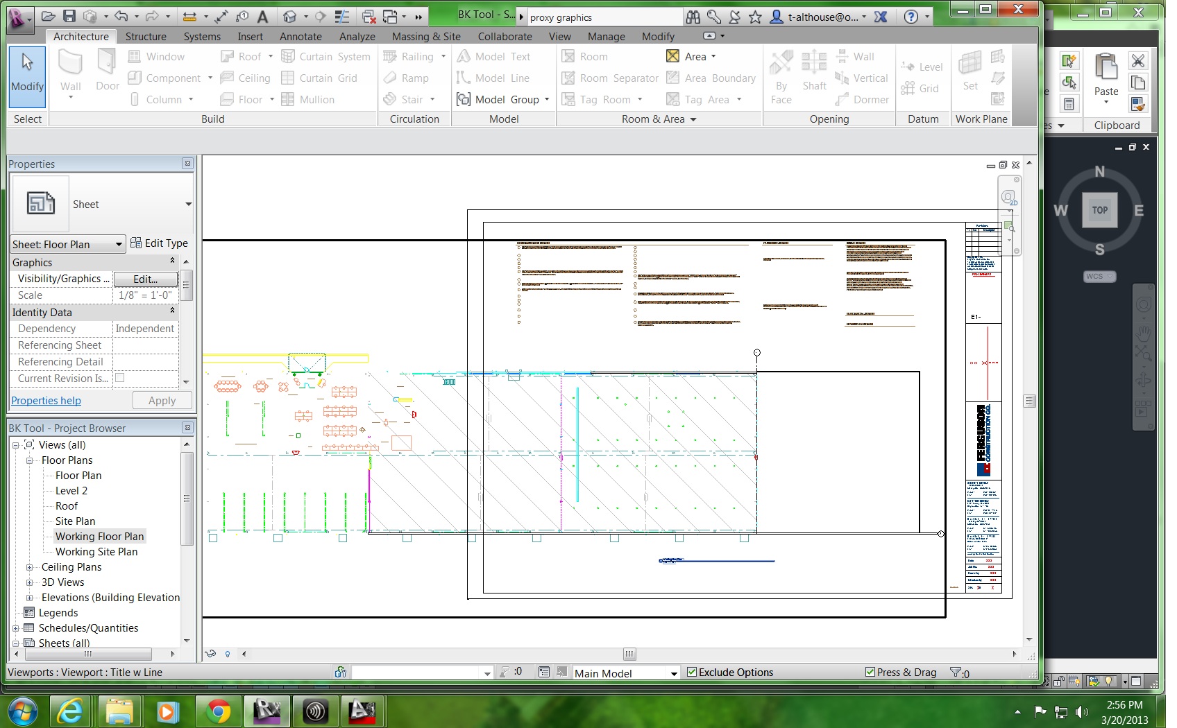

Ok when I import my CAD to get my existing wall lines, it says that I need to set proxy graphics to 0 or explode the dwg in CAD...I exploded it and still the walls are drawn as proxies, and I can't seem to find where to change proxy graphics to 0. Am I missing something?
Wed, Mar 20, 2013 at 1:58:37 PM | CAD to Revit
althouse08
Joined: Tue, Dec 4, 2012
24 Posts
Also is there a way to crop my title view? I don't want the CAD underlay overhanging like in the picture. As you can see, the new building will be to the far right, and drawn in revit, and the old is just shown for reference with the construction notes. Is there a better way to bring in existing CAD notes? This is seems to be the easiest way without retyping them all.
Wed, Mar 20, 2013 at 1:58:56 PM | CAD to Revit
You don't have walls! - You have lines ... And CAD defined lines at that!
After awhile, you will learn that you really don't want to explode CAD in your project.  It will just fill your linetypes, text types, hatch patterns with junk.  If you want to use the linework, clean it up in a junk file then copy paste into your project.
A better process - Link or insert your CAD and create your walls using Revit walls and pointing to the line in the CAD file.  Now you have walls - that can be in existing phase - and can be demoed or doors added or other Revit processes that you don't have with dumb lines.

I did all of that. Those are walls on the new building to the right...created in revit. And that is cleaned up haha I can't believe how much junk there is in CAD drawings. So If I don't want the lines hanging over from my import then I just need to delete them in my CAD file? Like I said the lines are just for reference..I understand how to pick lines and create walls and such, and I understand that I don't want to explode the CAD file in revit. However, I exploded it in CAD and imported it to revit to trace over it and the existing walls and proxy graphics did not come with the import. For the sake of it being a preliminary floor plan, I thought it would be much easier to just use the existing lines for reference, and just build my new addition in revit. I don't yet fully understand phases and I am trying to push that off until a future project.
Wed, Mar 20, 2013 at 3:29:17 PM | CAD to Revit
#10
If the CAD file is just for reference, have it linked in, in a workset that is set to be normally off in all views.  Then you can have it off in your sheet view but on in a working view.  << Note I recommend working views for model manipulation.  Sheet views obviously for annotation.
NOTE:  Even as an import or link (NOT EXPLODED), you can trace over linework and poit to lines to add Revit objects.
I suggest you do use phases as they are basically set up by default.  Just add all model elements that are existing in a view set to existing.  Then add new elements in a view set to new.

If you don't want the CAD import hanging off of your sheet you need to change the scale of the view or crop the view so that it fits on the sheet.
Mon, Mar 25, 2013 at 10:07:29 AM | CAD to Revit
#12
althouse08
24 Posts
Yea I figured that but I didn't know where to find the tool. Got it now. Thank you!
