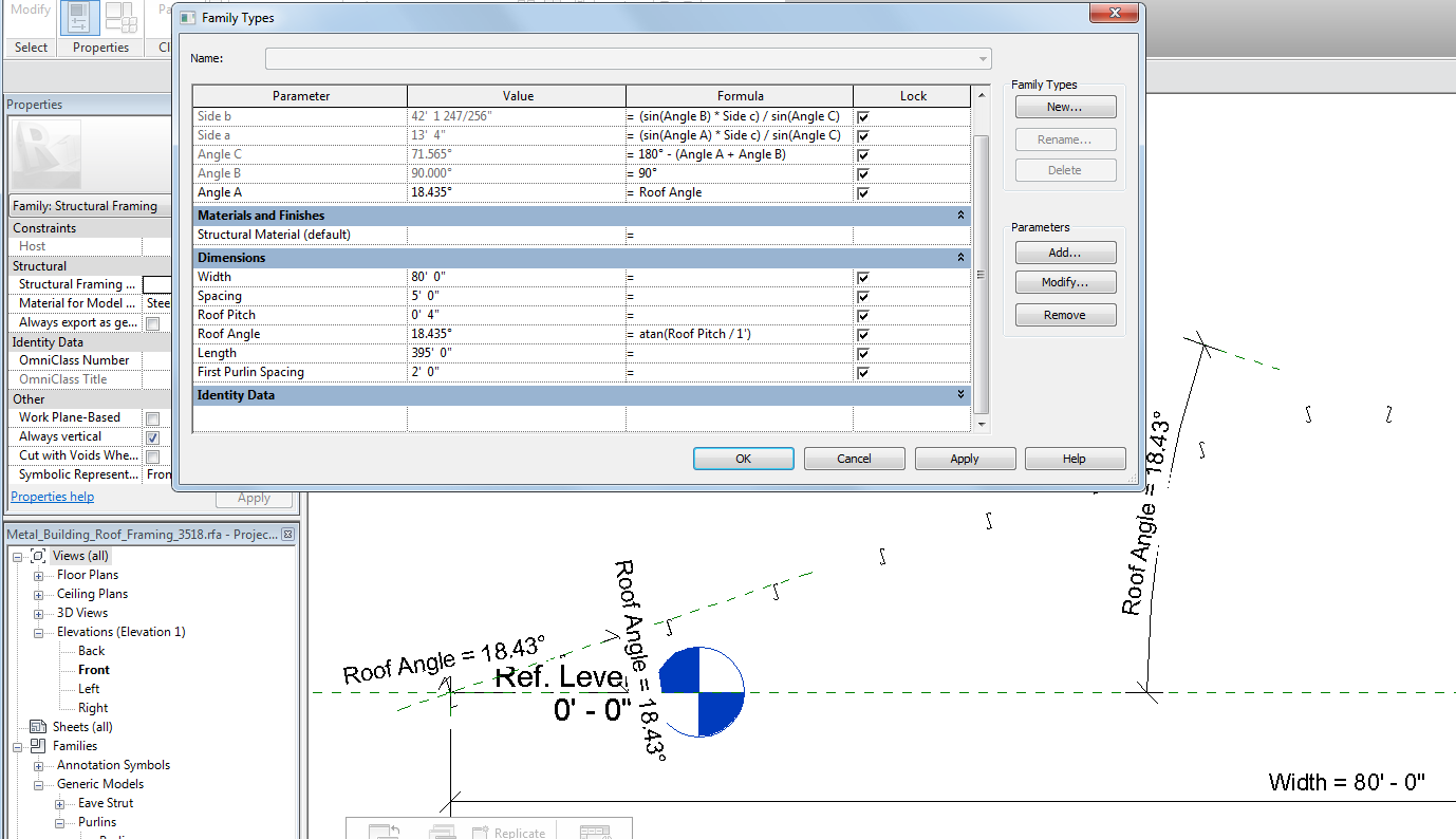

I do not know where I originally got my family.

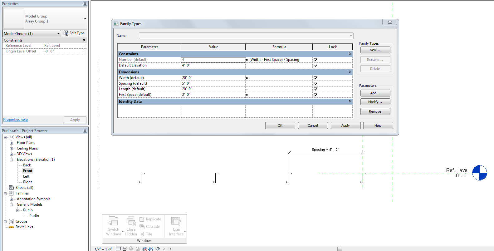

The individual purlin is nested in a "purlins" family that is nested in my roof framing family.
Attached are the parameters.
A good exercise to learn on.

Start with a non-hosted template and load in a purlin family.  For the framing family, you might start with one of the pre-engineered fame families here on RC.  Remove the solid elements and use the angle and span formulas that are already in the family.  Then insert the purlins family in that.

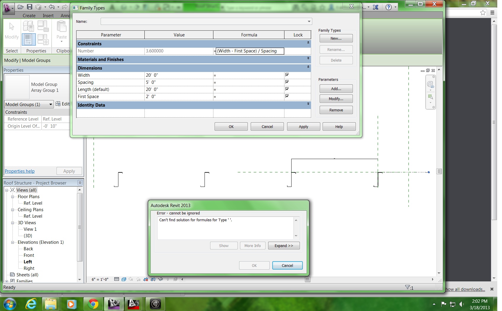

Ok this is what I entered and I got this error message. I am not sure if I am doing this right at all.

I still cannot seem to tackle this issue. Any idea what I did wrong?

First, although it appears that you don't have others,  - make sure you only have one type in the family initially.  You can add more types later.
This may be a units issue.

I think it just started with length..
