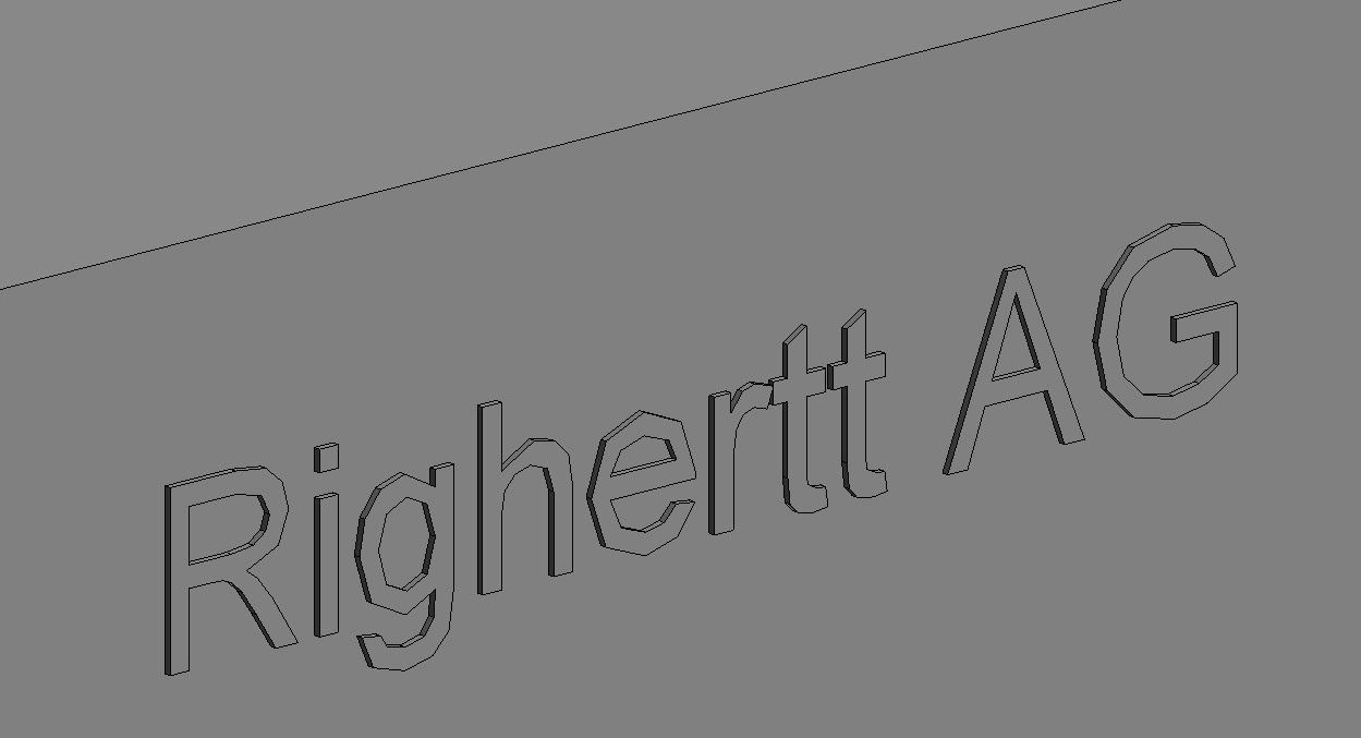

Thank you, WWHub!!! Model text is working pretty well, but is there any option to adjust the smoothness of the characters? See attached jpg.Regarding sweep - how can I create this one sweep? Do you mean to create kind of 3D spline as sketch path? Where can I find this option?
