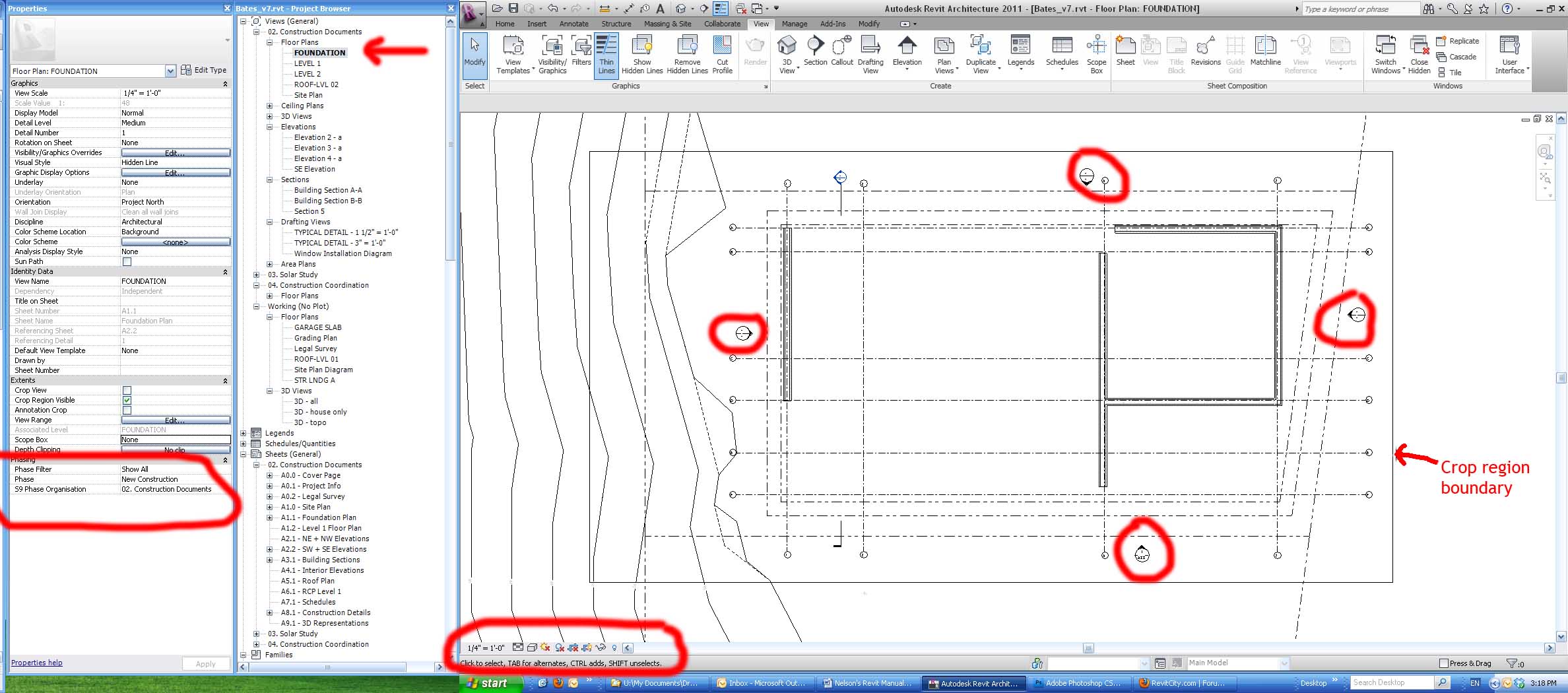

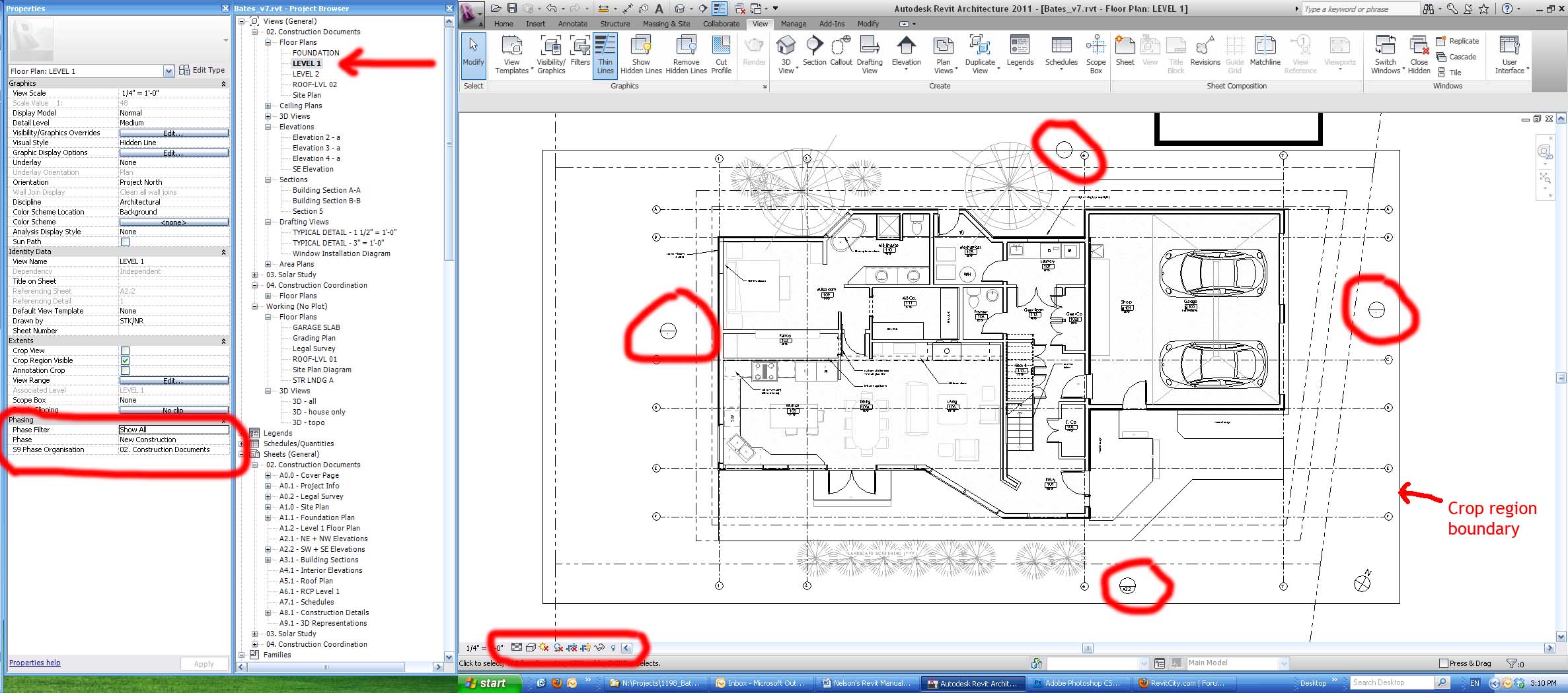

I have 4 elevation tags that are missing the arrow pointers in my all my floor plan views, I will use Level 1 as an example (see attachment S9-1). The one exception is my Foundation Plan where all the arrow pointers on the elevation tags are visible (see attachment S9-2).

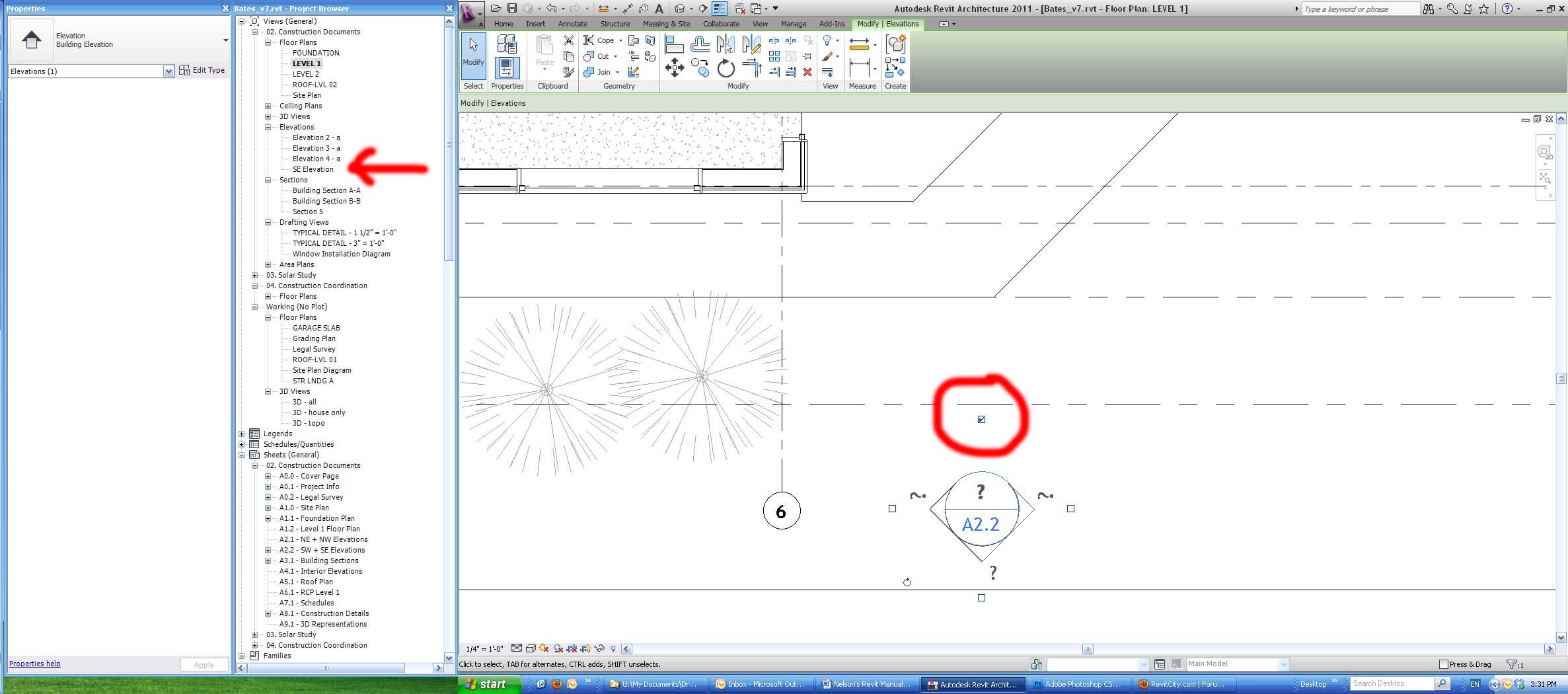

When I select the elevation tag, the checkbox that the elevation represents is selected and the elevation view appears in my Project Browser under 02. Construction Documents>Elevations>SE Elevation (see attachment S9-3).

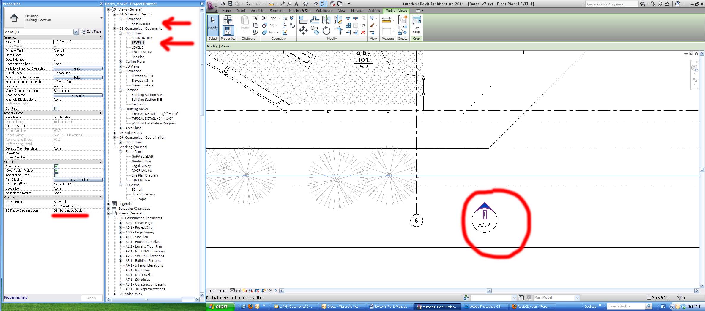

If I go to the SE Elevation view and switch the Phasing under 'S9 Phasing Organization' from 02. Construction Documents to 01. Schematic Design then go back to my Level 1 floor plan the elevation arrow now displays (see attachment S9-4).

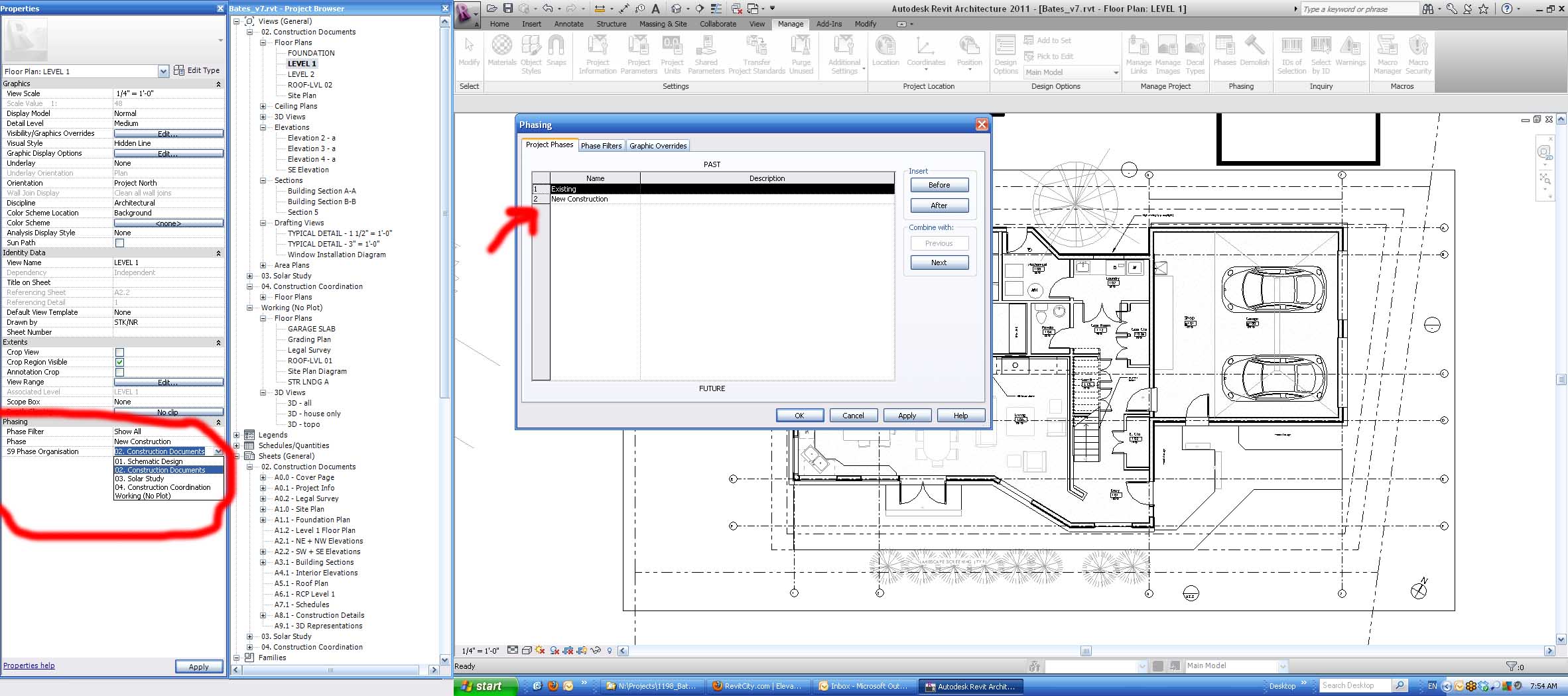

"S9 Phase Organisation" was set up by a previous employee presumably to set up some sort of file organisation system within the project browser to group drawings that were intended for Schematic Design vs. Construction Documents.  I didn't set this up so I don't know exactly how she did this. When I go to Manage>Phasing, the custom phases that she set up (4 in total) do not show up, I only see 'Existing' and 'New Construction' (see attachment)
WWHub:
The phase was set to '02. Construction Documents' when I created the elevation views. This is the one it should be set to because I want those elevations to be assigned to the Construction Documents phase. You can see also that I have my phase filter set to 'none' so there shouldn't be anything hidden because of this.
