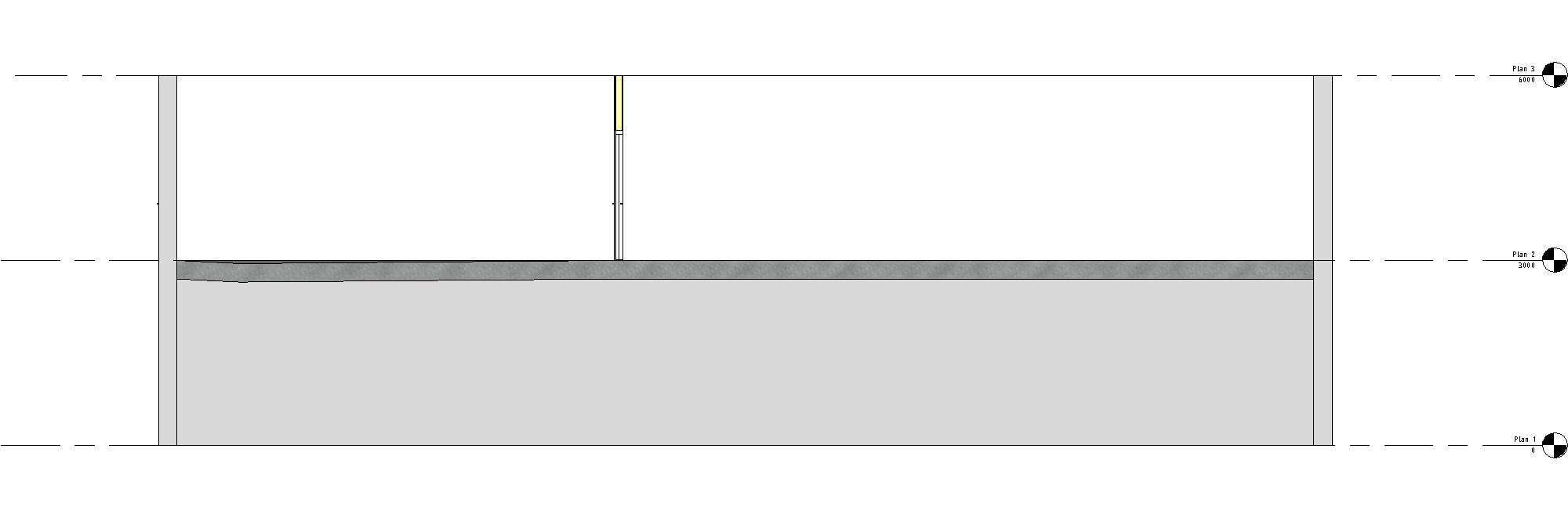

Ive tried to create a slope in the bathroom floor towards the shower area..
Ive managed to get the slope, but i noticed the floor si having an oposite slope below, and I would like it other side to be flat.. How do I do that?

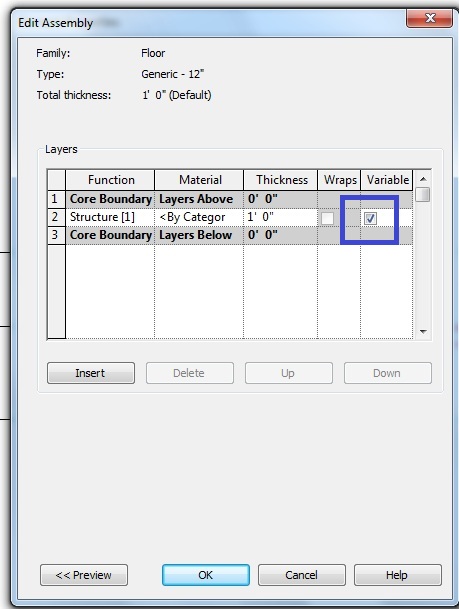

Check the 'Variable' box in the floor edit assembly.

Thanks a lot. Saved the day Smile
