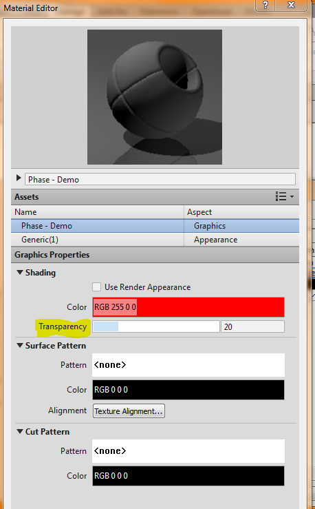

You can adjust the Transparency of the material (demo) for 'shaded' views. Not sure about hidden line however.

Thank you for your reply. It woulbd be good tho know how to change transparensy for shaded views too (when I change the transparency value for the colour, it does not work),
but the main thing is - to make them transparent for HIDDEN LINE views.

Again, thank you very much for the image. One image worths 100 words.
However, is 20 a Transparency value? I think it is an Opacity value. If transparency is 100%, the object is completely transparent. Correct?

"However, is 20 a Transparency value? I think it is an Opacity value. If transparency is 100%, the object is completely transparent. Correct?"
Did you try it to see what it does?

In plan views it does not change at all, just in 3D. They look the same with differevt values of transparency.
