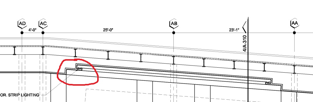

Please see attached image.  Does anyone have any tips on creating this ceiling?  I was doing to a wall/ceiling combo, but the "wall" would be perpendicular to the ceiling, which is sloping.  I hope this is enough information.  Thank you in advance.

Create that with Model In-Place in ceiling category

and I guess I can add by extrusion.

I would probably do this different than TY.
I would create the lowest portion as a sloped ceiling with a hole in it, then the upper most ceiling sloped.  Then do the light trough with "verticals" as a sweep around the edge of the hole in the lowest portion.  This would allow for some easier future adjustments.
