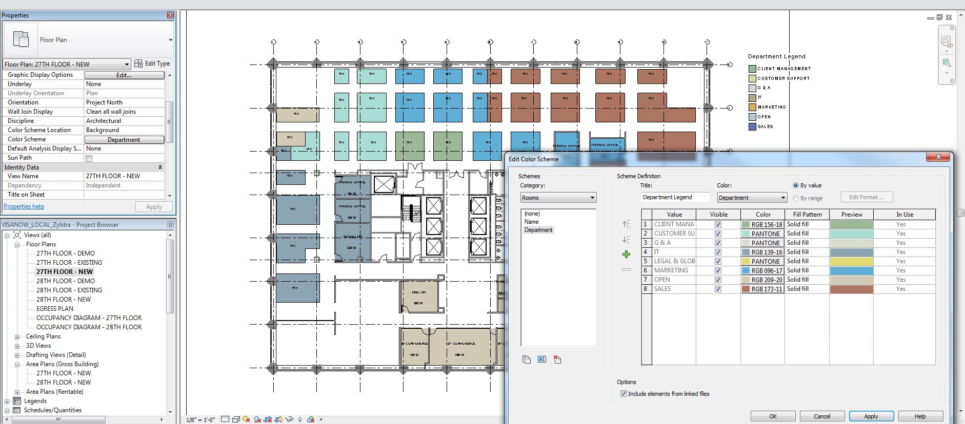

RobertZ
Joined: Mon, Sep 15, 2014
0 Posts
I am having the same problem. the legend doesn't even match the color dialogue box color. But the color is correct in the plan.
See attached.
Let me know if anyone ever found a fix for this problem?
