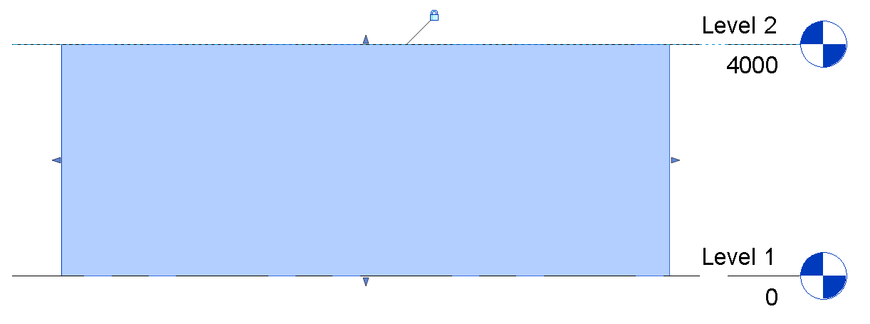

Go to an Elevation or Section view and then us the 'Align' tool to align the top of the Mass to the Level and Lock it.
