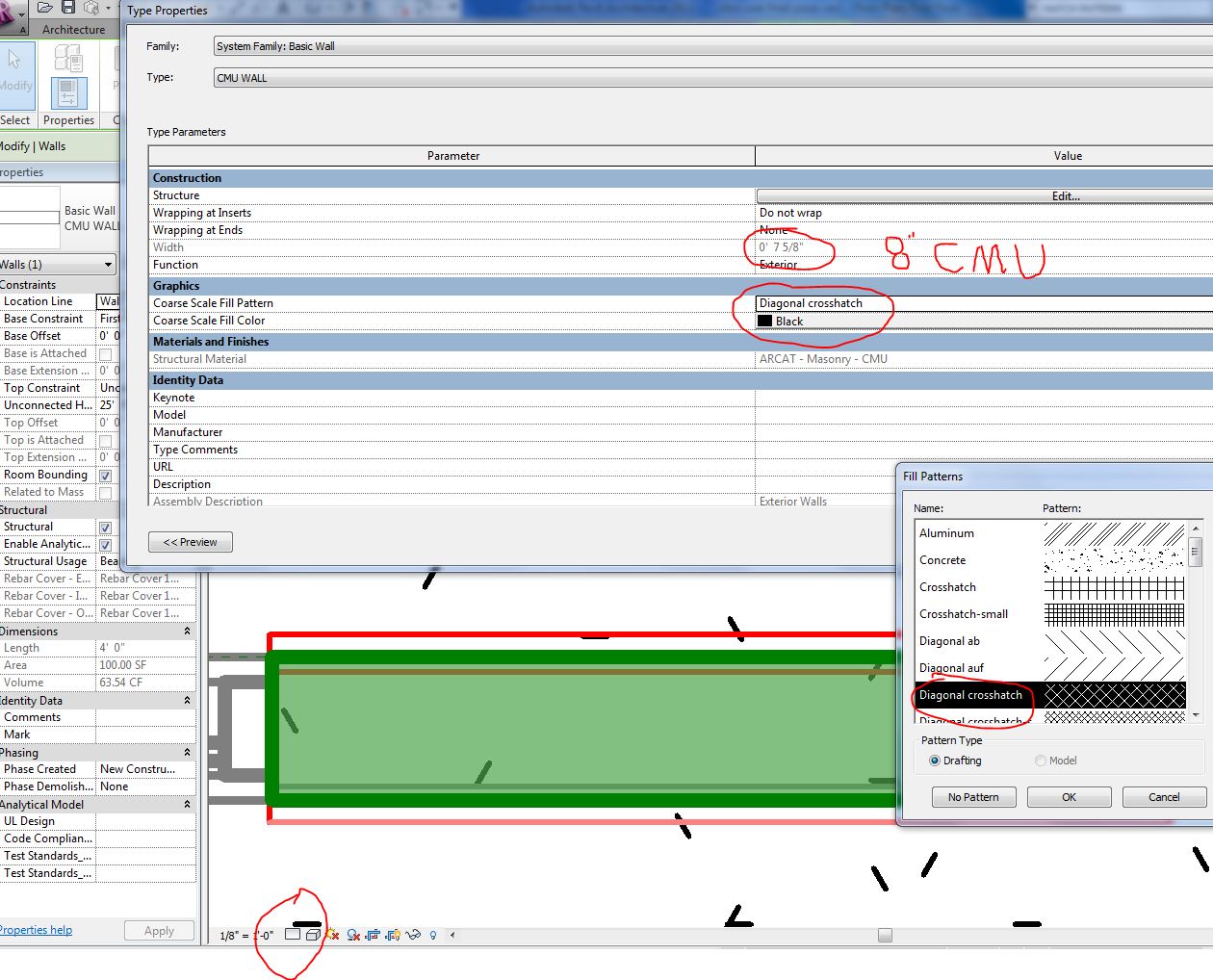

Hi! Here is some additional info.: (see attached screen shot)
The view setting (I tried all three coarse, medium, and fine)
The wall is an 8" CMU or block wall (its 25' tall)
The View Range is default Top at 7'6" cut at 4'2"
The hatch is the standard diaginal
The scale of the drawing is 1/8" = 1'
Thanks for your help, I appreciate it.
Take care,
Rob

Fri, Mar 1, 2013 at 1:55:02 PM | CMU wall - hatch pattern not showing in plan view
You are setting a coarse fill pattern.  It will only show in a coarse view - not fine or medium.
