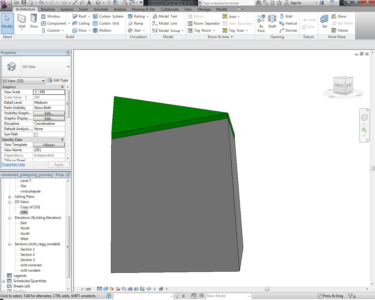

I have a problem with creating a section through a slanted wall. i am gonna use it to create window and door openings.
Anyone with experience about this?

"I have a problem with creating a section through a slanted wall" - Goto a plan view and create a section... BUT I believe this is not the real question, right?

That is not the question. When i create a section in a plan as usual, only some of the wall is visible, because it's slanted. So what I wish to do is create a slanted section that is the same angle as the wall, and therefore follows it.
Understand?

You can rotate any section depending on your needs.

Thanks that really helped!
