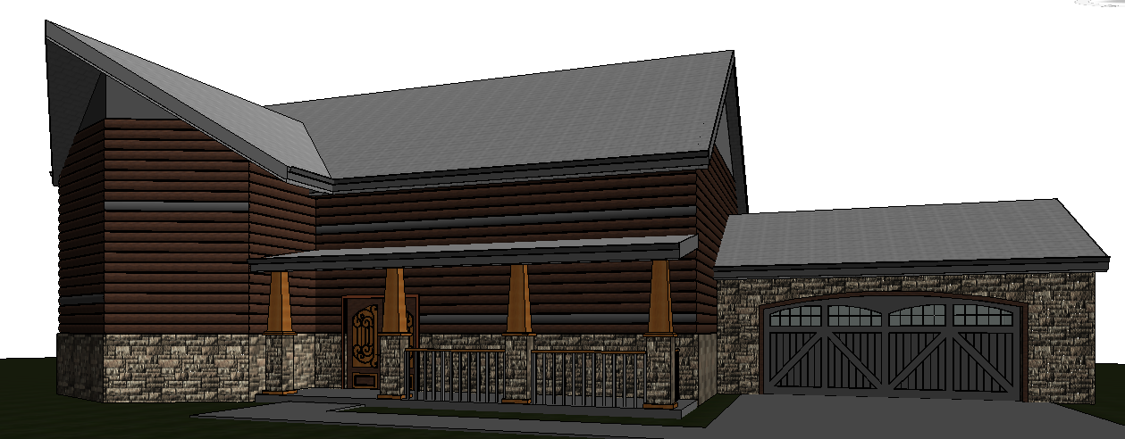

I am currently building a log cabin type house and am having some troubles. To make the "logs" on the cabin, I've used a series of wall sweeps. I changed the material of EVERY sweep to be wood (I double and triple checked this one). For some reason a few random sweeps (refer to picture) seem to show up as grey. The view is a "realistic" 3D view, but the problem also arises in a rendering. Does anyone know of a solution to this problem? Any help will be appreciated.
Thu, Feb 28, 2013 at 10:33:40 AM | Wall Sweep Modifications
Sweeps do not work well with this.  Check out this thread:
http://www.revitcity.com/forums.php?action=viewthread&thread_id=17944
