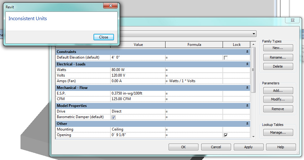

Fri, Dec 13, 2013 at 4:21:09 PM | 'Inconsistent units" error in parameter formula; length vs integer
Gehrys
Joined: Wed, Jul 4, 2012
5 Posts
So im trying to get a result of Amps from the Volts and Watts parameters.  Ive tried to neutralize the units with " (Watts / 1) / Volts " but still get the inconsistent units error.
Any ideas?
PS - I know the image shows watts * volts which is wrong, but still wont run the formula.
Edited on: Fri, Dec 13, 2013 at 10:30:35 PM
Fri, Dec 13, 2013 at 10:37:04 PM | 'Inconsistent units" error in parameter formula; length vs integer
Gehrys
5 Posts
Ok, got it.....
(Watts / 1A) / (Volts / 1A)
