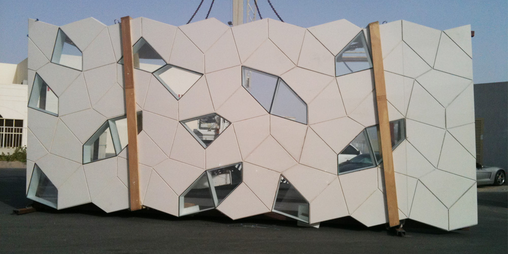

Hi all,
I am trying to create a composite cladding system with repetitive geometric pattern, (i will add the picture of desired look). the problem i have is i don't know how to design this in revit! i think if i used a curtain wall family and added parameters i could make this desired look, but i dont understand how to do this. can anyone help as this is for a project i have at university. P.s i am using revit architecture 2012 and live in the UK.
thanks
Callum

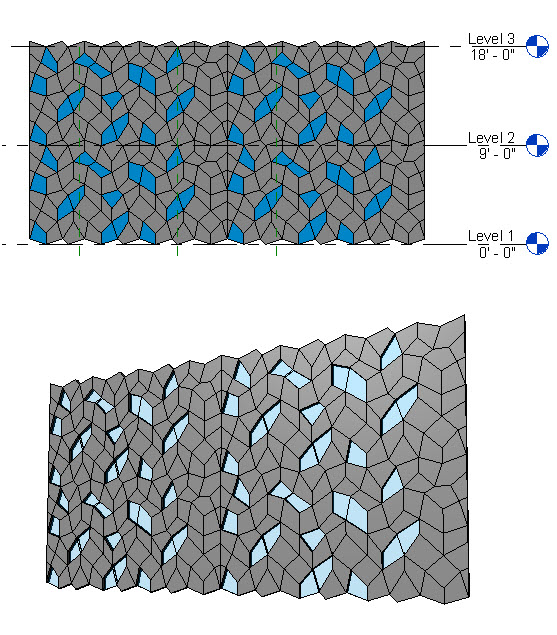

You could model that object as a curtain panel family, and then apply that panel to a curtain wall. This curtain wall element has two rows and two columns of the panel, put together:

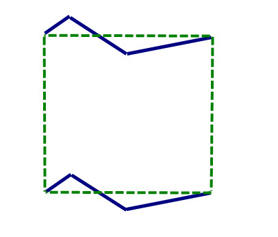

You can go in and out of the reference planes of the curtain wall panel family, not only in x, and, y, but also in z.  Remember the other thread about the perforated panels and the "x"?
In case of the panel in this thread, the top and bottom are made as in this simplified scheme: the same portion that goes "out" above the upper reference planes, comes "in" above the lower reference plane. Something similar could be made from left to right.
