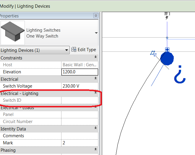

Hi,
I am trying to add a switch to a 'Switch System' and it doesn't appear on the 'Options Bar' drop down menu and when I try to select the switch in the View it is not selectable. The field for specifying a Switch ID is grayed out in the 'Properties Palette' so I can't input a Switch ID. Can anyone tell me why this is please? I a have attached a screen shot.
Thanks
Peter
Tue, Feb 26, 2013 at 8:43:57 AM | Switch ID Grayed out in Revit MEP
Look at the Type properties.
Tue, Feb 26, 2013 at 11:33:36 AM | Switch ID Grayed out in Revit MEP
designimpressions
Joined: Fri, Jun 6, 2008
47 Posts
I got it. Part Type needs to be set to Switch in the Family Instance Properties.
