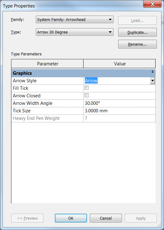

Actually you can create custom arrowheads within reason. You are limited to the basic shapes but you can modify those shapes and I believe you can in fact do what you want to do.
Under the Manage tab > Additional Settings > Arrowheads, there is a fair bit of customizing available.
Just like every other Type in REVIT , Duplicate the Type (rename it) then use the properties of Arrow Style, Fill Tick, Arrow Closed, Arrow Width Angle, Tick Size and Heavy End Pen Weight to create you own custom arrowheads.
Once defined you can then apply thiose custom arrow heads as a property of your Text Types, Dimensions, Tags and Annotation type. Basically the arrowheads are a nested property in your annotation type.
Maybe have a look under the Additional Settings menu . . . . . . there's all kinds of goodies in there.

Here are my text arrows I just adjust them using the dialog that dgcad has shown. I have just changed my "Arrow Width Angle" to 90 deg
