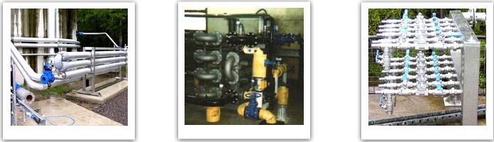

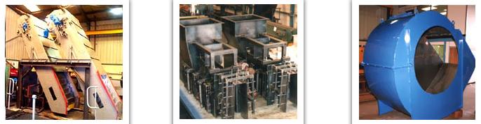

Hi people,As an estimator with a background in AutoCAD and other basic 3D design software I am considering to propose a BIM package to benefit our estimating, design and fabrication processes.  My company however is a specialist fabricator designing bespoke products such as pipework and tanks for the water and food industries (please see pictures attached).  We also fabricate bespoke access systems and even architectural steelwork such as cladding and railings.Any thoughts on whether Revit MEP / Revit FabMEP might be suitable for our purposes and how it would specifically improve our estimation and fabrication processes?Thoughts are most welcome!Baz,Estimator, UK.

This is all very do-able in REVIT (mainly the MEP tools) . It will be made up of custom external .rfa families and some in-place families as well as the OOTB piping equipment tools.
This will equate to using what is called 'Shared Parameters' which will enable you to schedule everything. Shared Parameter will be a MUST and has to be setup BEFORE you start to model anything.
Using REVIT Assmblies may also come into play.

Thanks a lot for your reply. I was initially looking into other BIM software such as Tekla but found these are more suited to structural design processes and that they lack the flexibility of Revit.  Do you think i would also require FabMEP?If you have any examples of revit models for products similar to those in my attachment then I would be very interested in taking a look at them.  As mentioned I am very much a Revit beginner who will potentially be responsible for all Revit work at my company so Im sure I will have more than a few questions along the way. I may indeed call on companies similar to yours for your training services.Regards,Baz.
