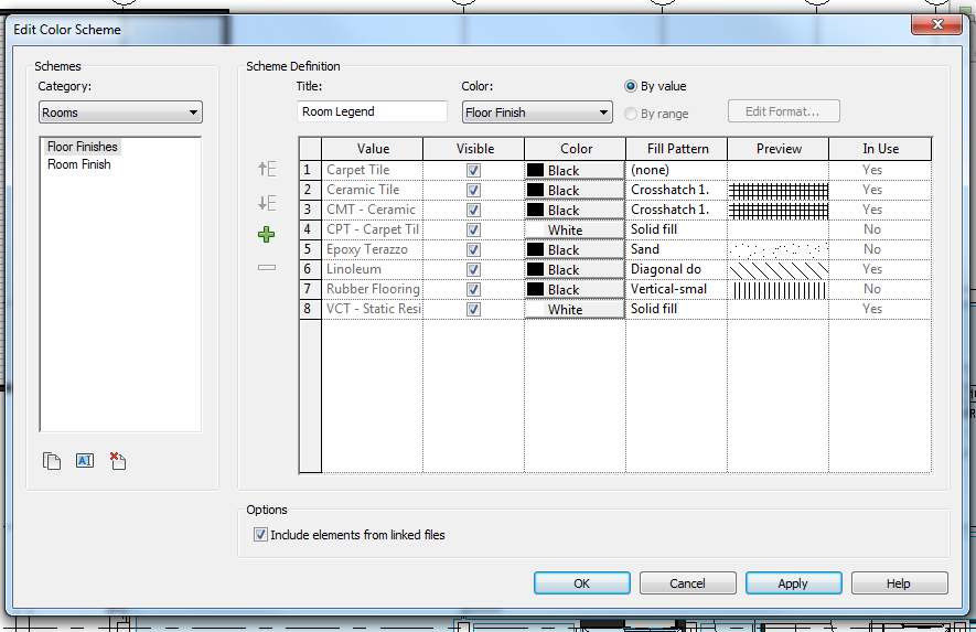

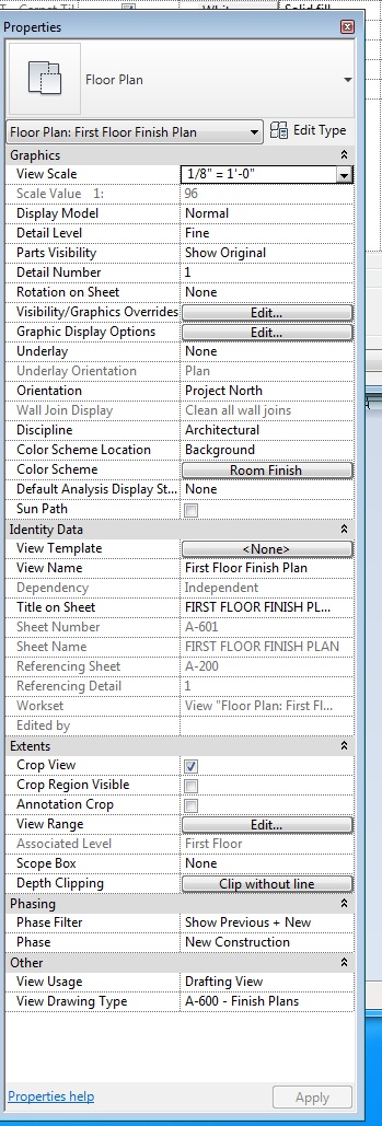

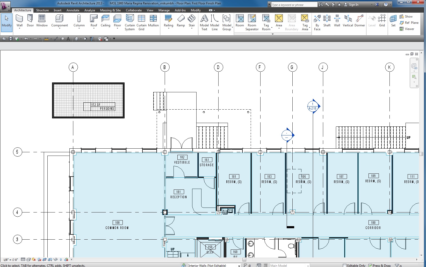

Hi
I have a file that I have applied different floor finishes to different rooms based on flooring patterns and hatches - they are not visible in the floor plans . Funny thing is if I make a seperate room outside the project in the same view and assign it flooring patterns - it does show up all the floor finishes. The only reason I can think of is phases. Please help.  I have attached images for reference.

No they dont show up in the section. They are not 3d surfaces - but just pattern hatches - made to indicate nthe new flooring layouts. I made a seperate room next to my building and tried applying these hatch patterns to the room - and I can them on that - but I cannot actually see them on on my flooring finish plan. All I get is a series of blue colored plans.

The rooms will not populate with a color unless you set the associated parameter.
Also - some patterns do not show at small scales.

Thanks for replying. Ya you are right- these are not materials with actual thicknesses. These are just 2d hatch patterns used to denote floor finishes in a 2d floor plan view. I created it using the same method as we do a color legend - but replaced the colors with hatch patterns. It seemed to work for the small room that you see floating above the blue bulding hatch in the drawing - but when i apply it to my actual bulding it does not show up. I donot think its a problem of hatch scale as it does show up in the building next to it. My hunch is it must have something to do with phasing. What can I do about this?

Change the view phase settings and see what happens.
We can only guess otherwise because you don't show us enough .... like the room properties.
