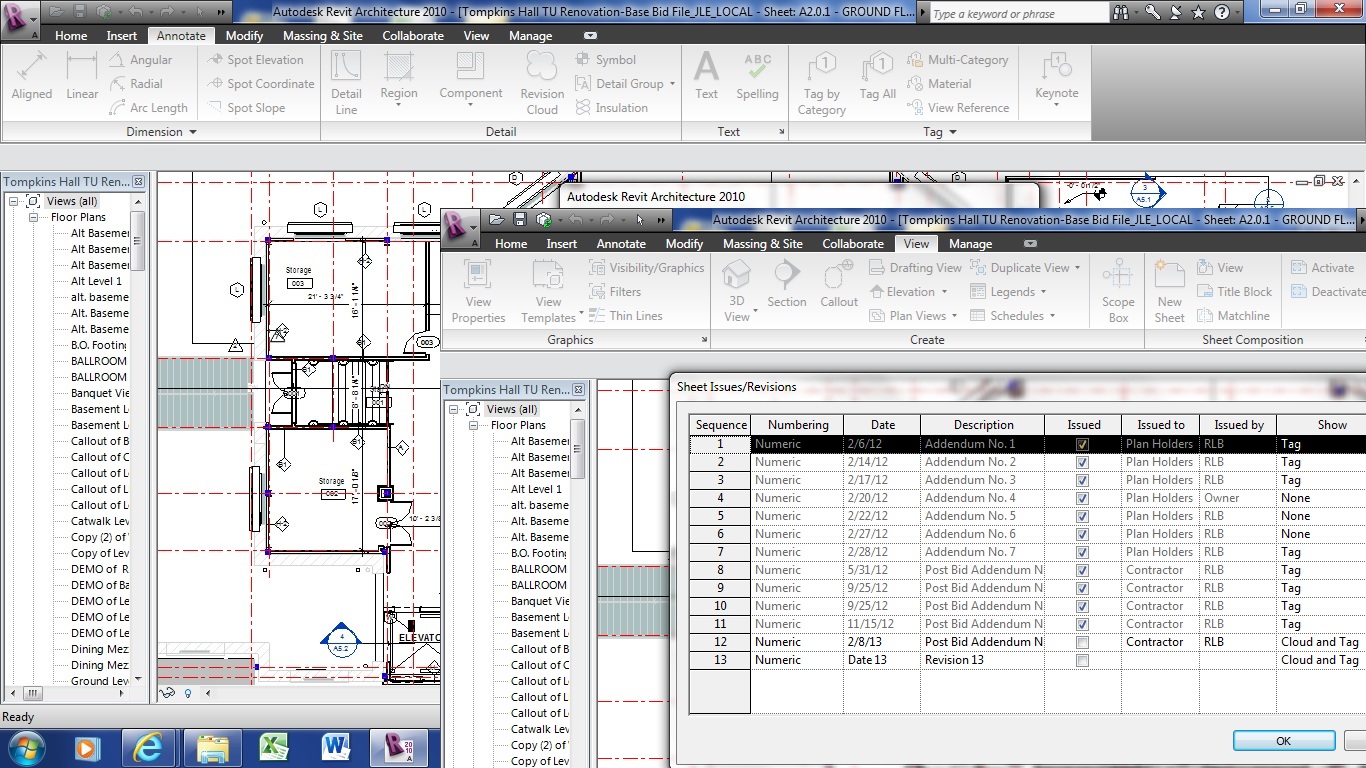

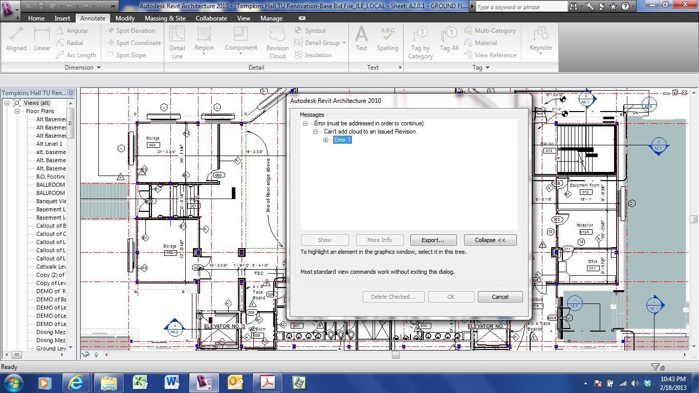

Post an image of your revision dialog box and the error that pops up when trying to create a new revision cloud.

teafoe5, see attached images.  WWHub, I drew a new cloud.
