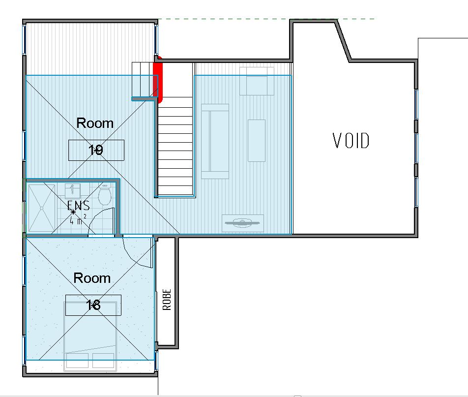

Hi all,
I have been trying to place a room in a floor plan and revit dosen't want to recognise the full extents of the room. I have never come accross this before and it has got me totaly stumped. I have attached a screen shot of whats going on. The bold red line is a room seperation line. Any help with this would be much appreciated.
Thanks in advance.
Sat, Feb 16, 2013 at 4:33:13 AM | Room Boundary Issue
dpoll
Joined: Mon, Feb 9, 2009
3 Posts
I've figured it out the room was in conflict with a curved roof (by extrusion). So I selected the roof and unchecked room bounding.
