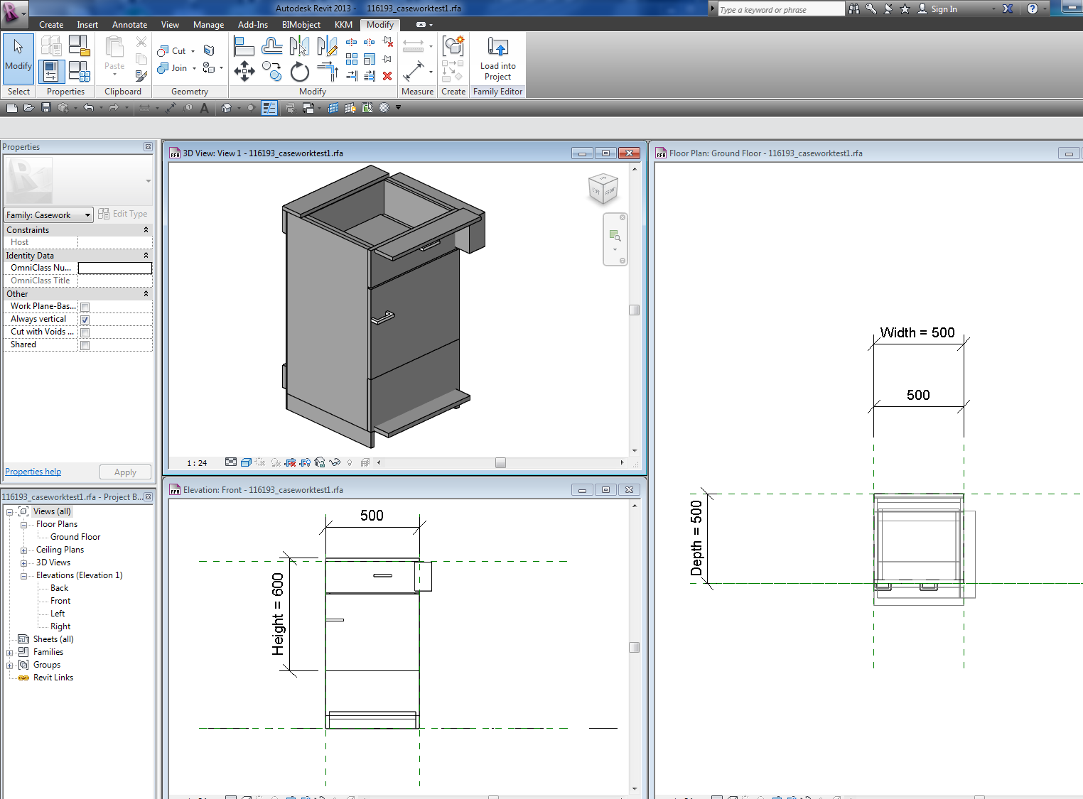

Hi,
So, I need to create a cabinet where I can change the how many drawers/doors are on it. I am told this is possible using revit using parametric families?
Can anyone help me with this project?
I have attached my base cabinet.
Thanks so much,
Dave

Yes you can create a parameter for doors and drawers.  You might find one already done here in the download section.  Otherwise you need to read Autodesk Families guide for creating families.

FIRST take a look at your family, it's NOT completly parametric yet, look what happen when you flex that family....

I will work at making it parametric first then...
