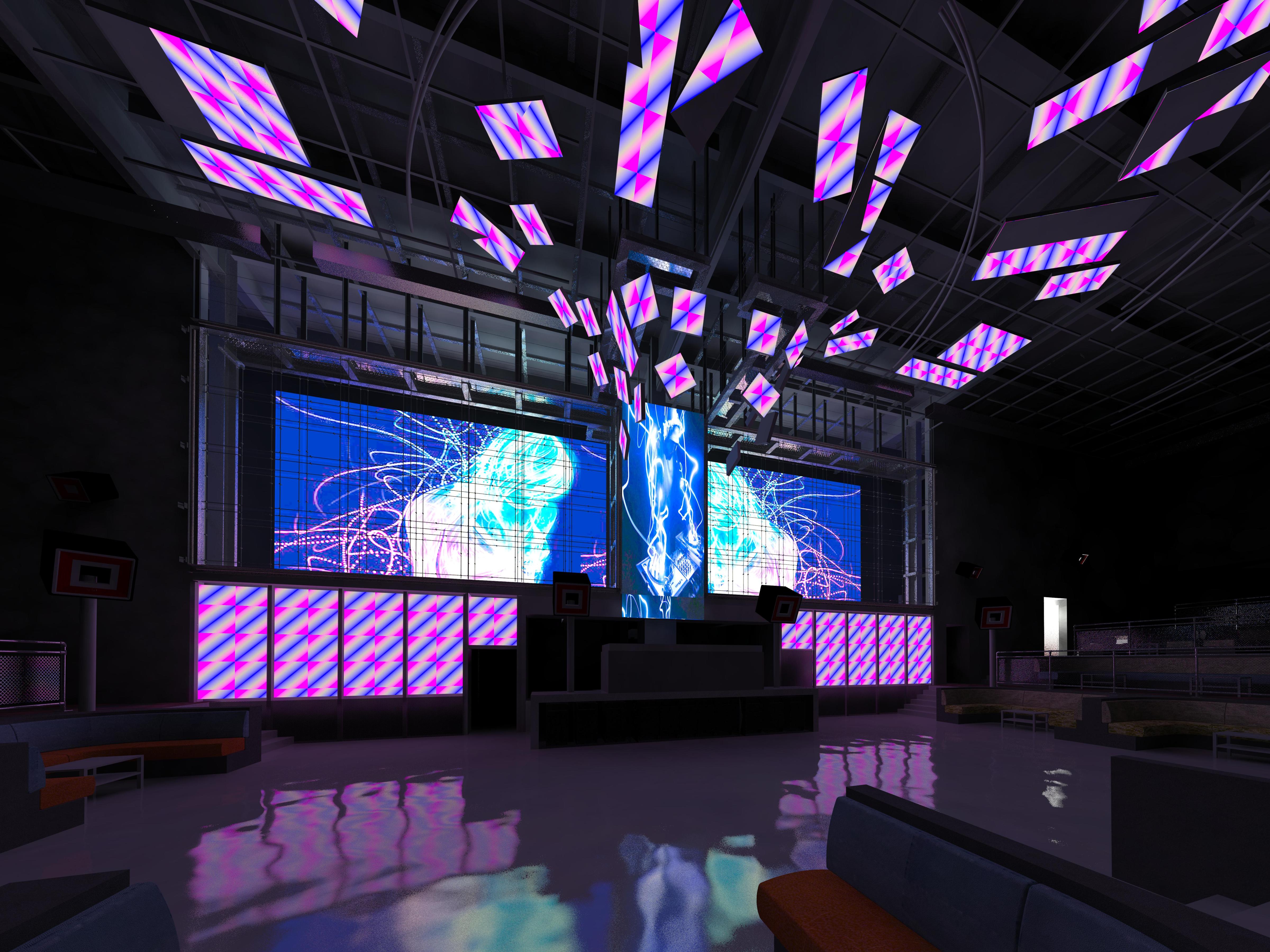

technically i only use revit for construction documents. i use 3ds max and Octane Render for rendering. but... when i DO render with revit I do 40x30 crop size at 300 dpi medium settings. i never go above medium

this took about an hour on my e5-1620 at medium settings
