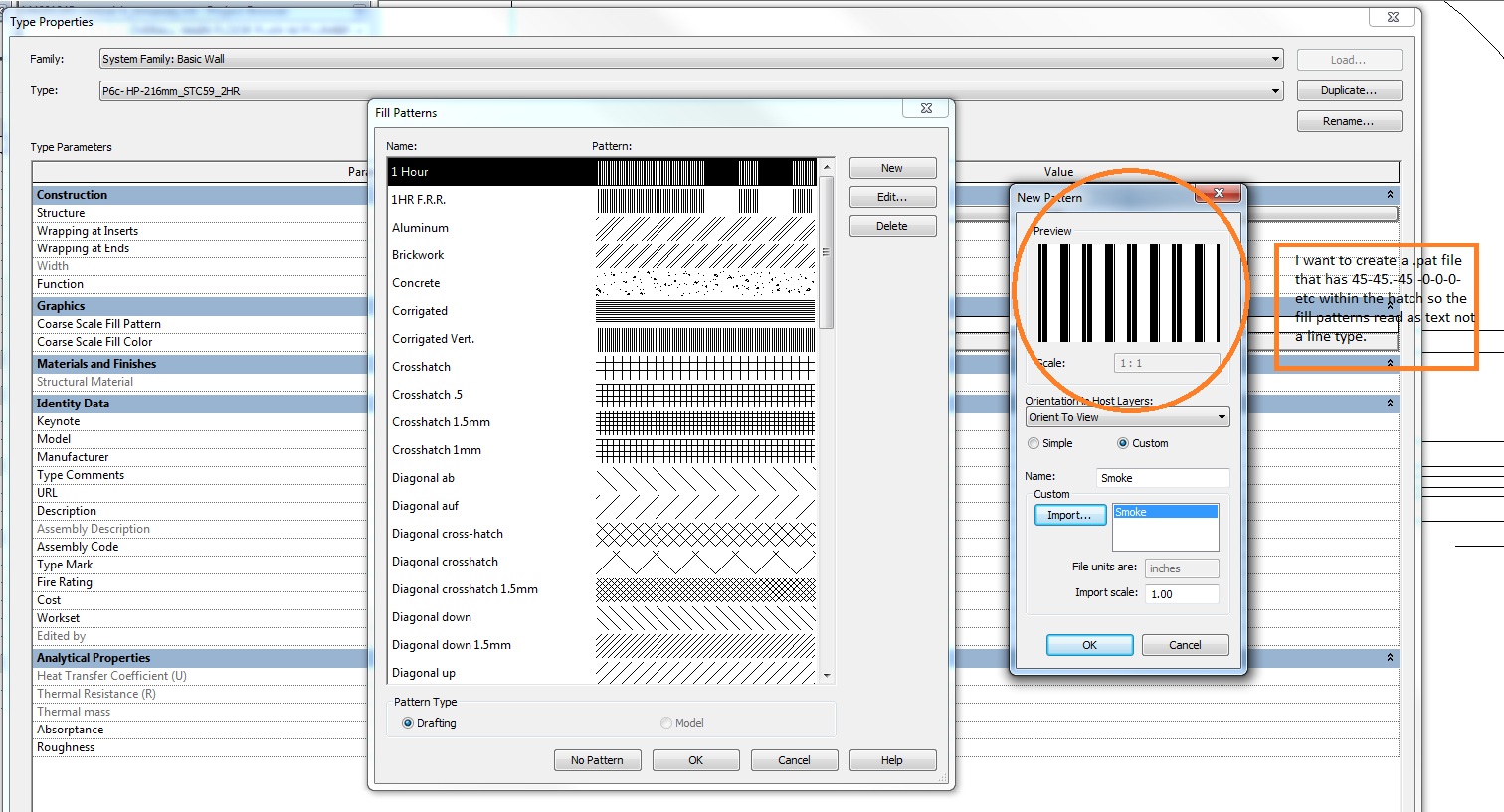

I am trying to add a pattern to the coarse scale fill within our wall assemblies that displayes STC and FRR requirements
e.g.
0-0-0-0-0 or -stc-45-stc-45- etc. I am able to make a custom pattern with linetypes but I would like text to show
I know how to add a coarse scale fill I cannot find a way to create this as a pattern in AutoCAD to import or ccomplete this in revit.
Thank you

Please see attached jpg. In wall assembly structure material; editor I have assigned a pattern for 2 hour rated wall. instead of showing linetypes I would like the pattern to read -0-0-0-0- or -stc-45-. This is what I am trying to accomplish so the walls read on our 1:50 1:25 plans.
I cannot figure out how to create this pattern.pat file for import

I don't believe you are going to be able to do what you are looking for.  You could add a different fill pattern to each wall and have a legend explaining the fill or as Typhoon suggested use a line based family and draw around the walls you need.
http://www.revitcity.com/downloads.php?action=view&object_id=12871
