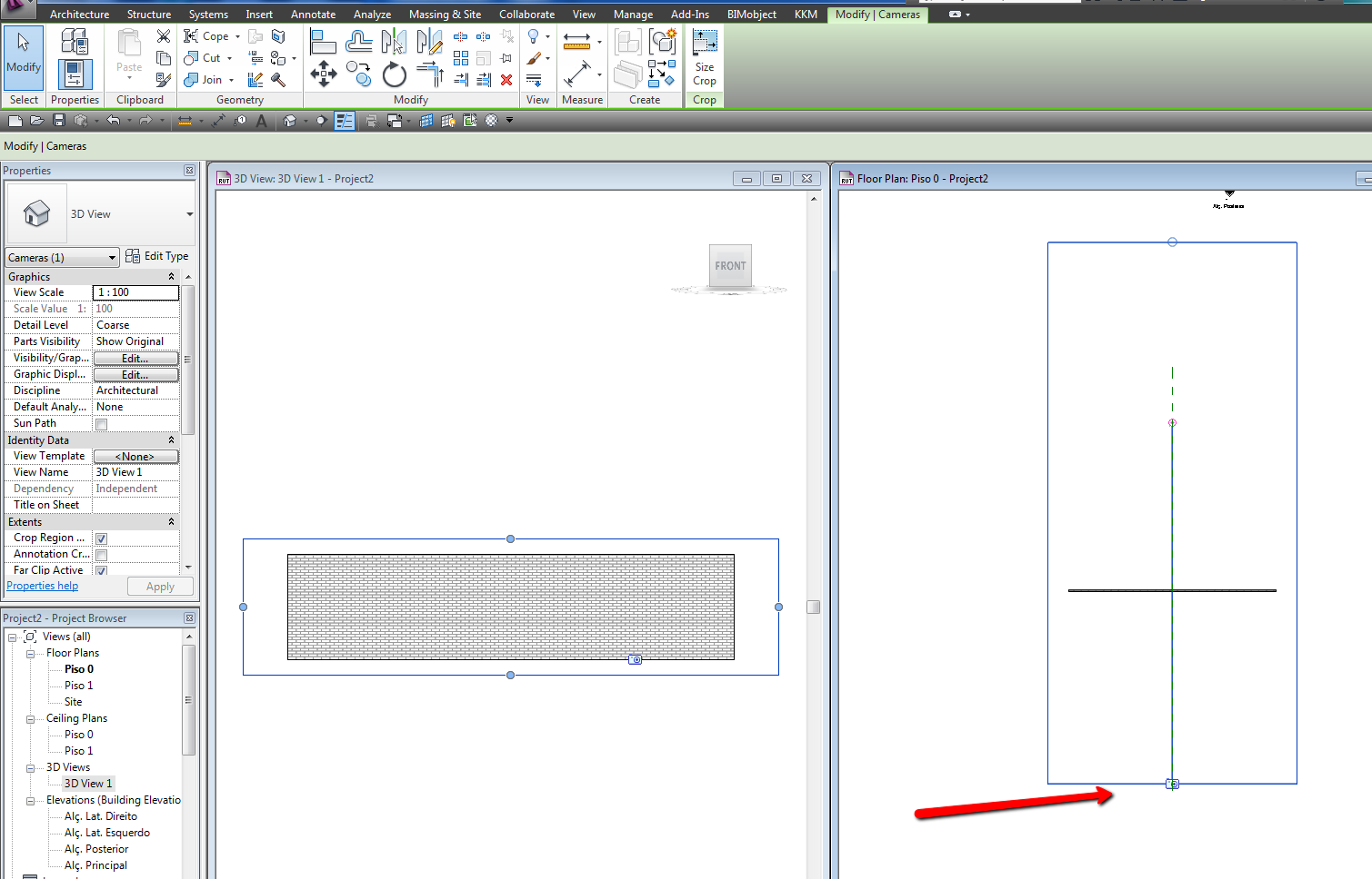

how can i uncheck the grayed out box on a camera view so it is not a perspective view. i need to just render a flat elvation with no perspective.  i have been using revit a long time but only just recently getting into rendering with it.
thanks

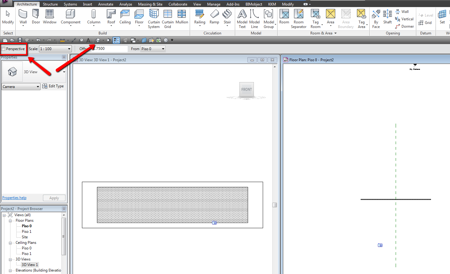

Create a "Camera view" but uncheck "Perspective", now you can render

thank you, i was trying to do mit after the fact. i did not see the check box as i was making the view.  thanks again
