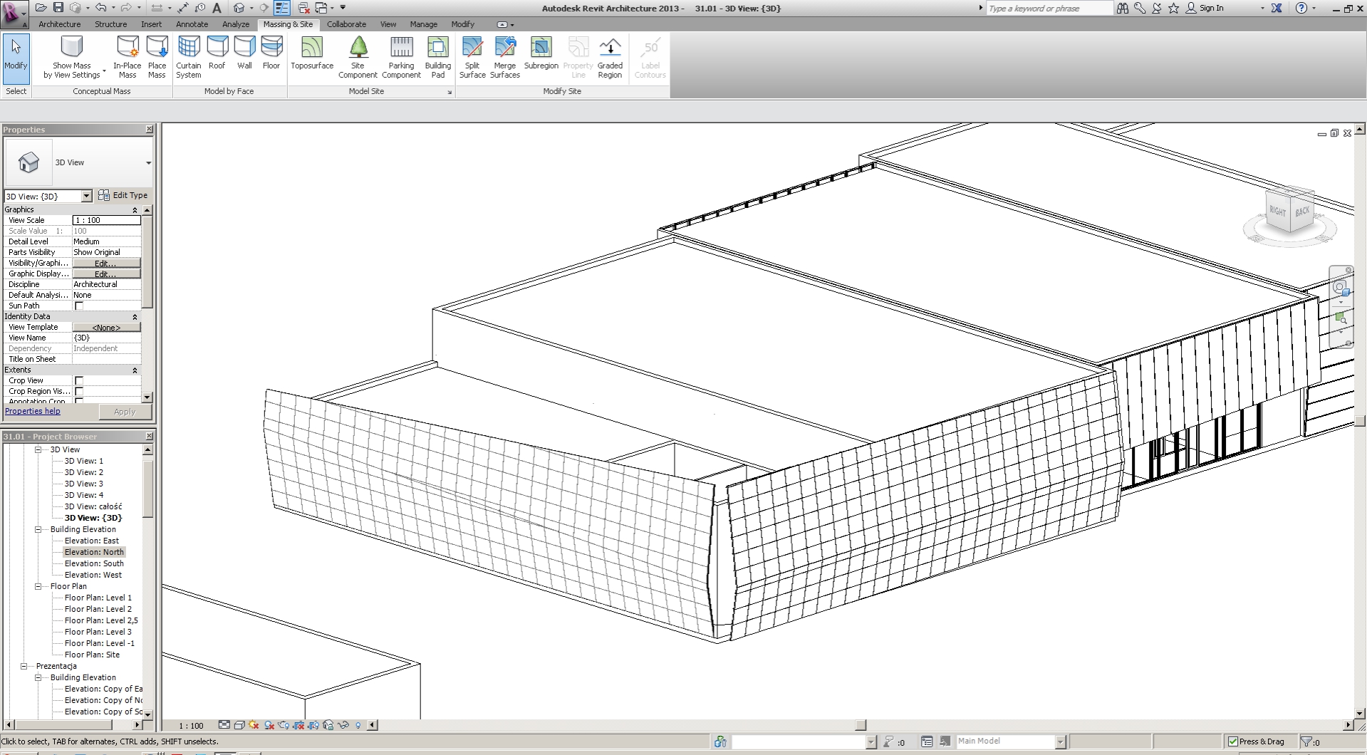

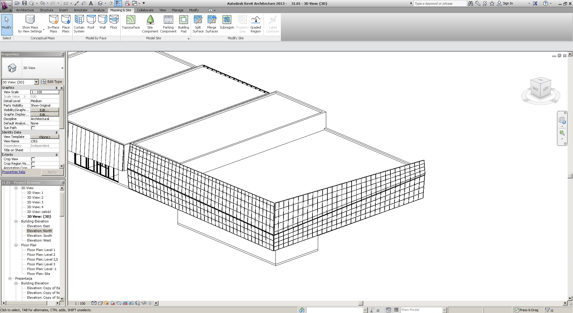

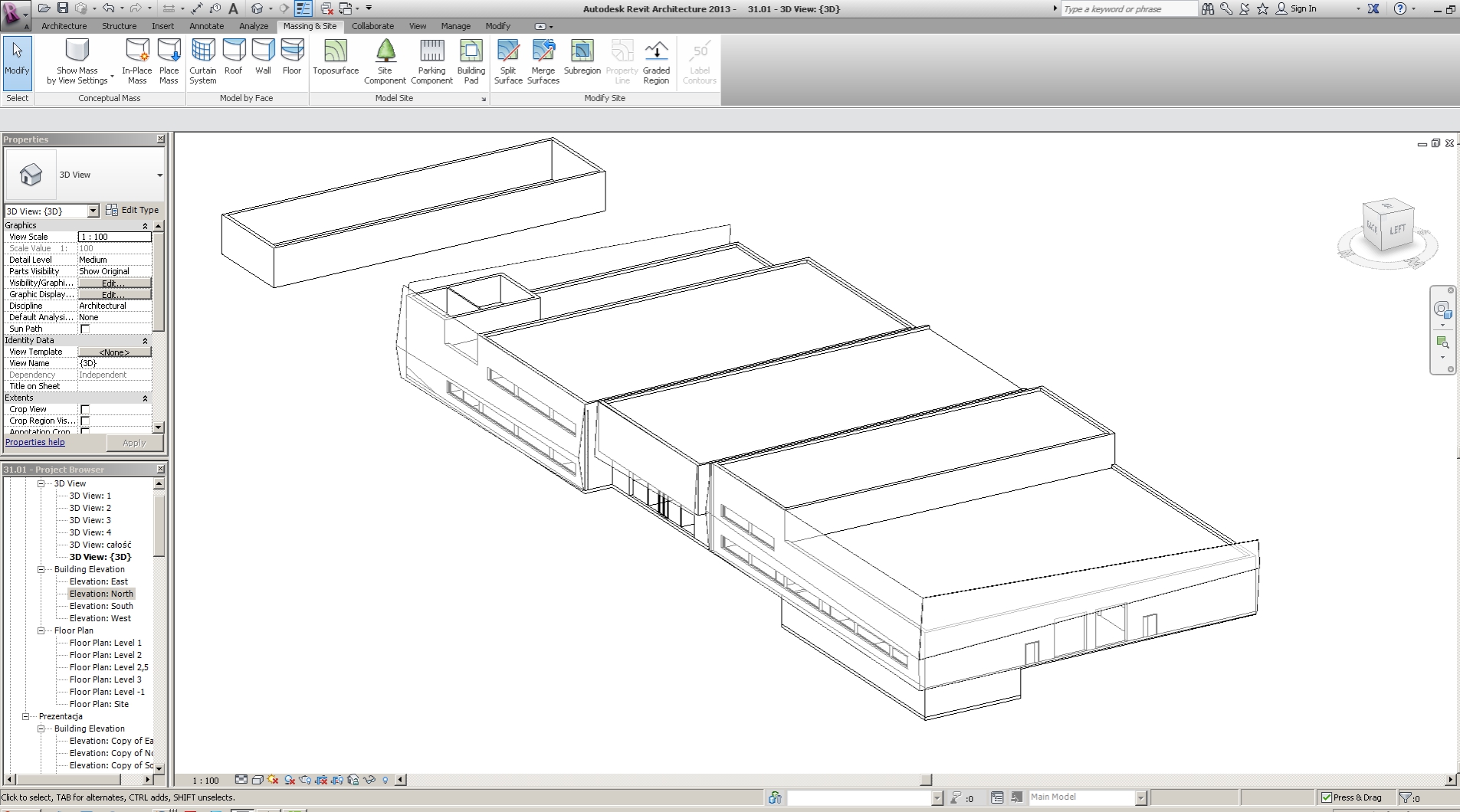

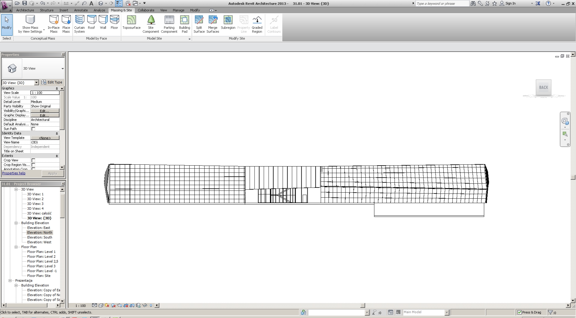

My problem is as follows:
I'm trying to build a shell around my building that consists of sloped surfaces (planes) of a different shape. I need to divide it to check some design possibilities.
Everything goes right as long as i'm not building the corners. Once i do that curtain wall system's grid is becomming angled (not just vertical and hirizontal) and I can't rotate it.
Images attached.

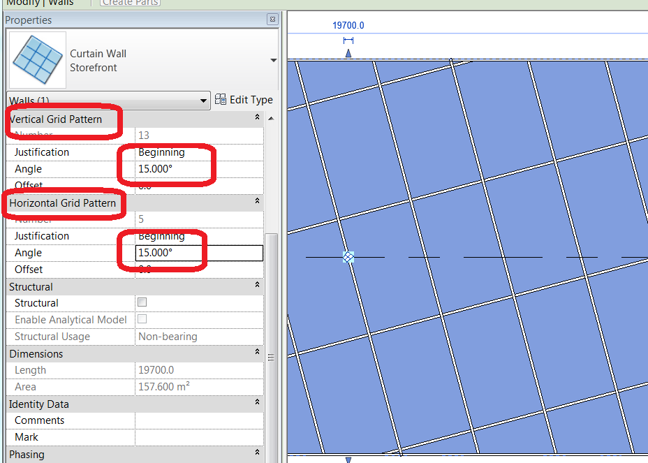

Click the curtain wall as a whole . . . . . are getting the instance properties to adjust the curtain wall grids ?
See attached inage.

In those walls which are closing the corners Ican only adjust offset. Angle adjustment is not available.
