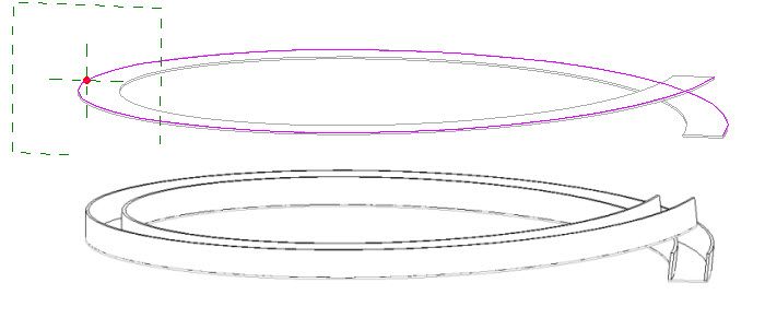

I've been searching for hours on how to make a wall that is curved and slanted and follows a ramp. This is what I am trying to do:
http://www.revitcity.com/forum_files/104999_voids.png
This is the closest tutorial that I have been able to find. But I've never worked with swept blend tool and can't seem to figure it out.
http://www.revitcity.com/forums.php?action=viewthread&thread_id=27094
If you can walk me through it step by step, I'd be really greatful! Thanks!

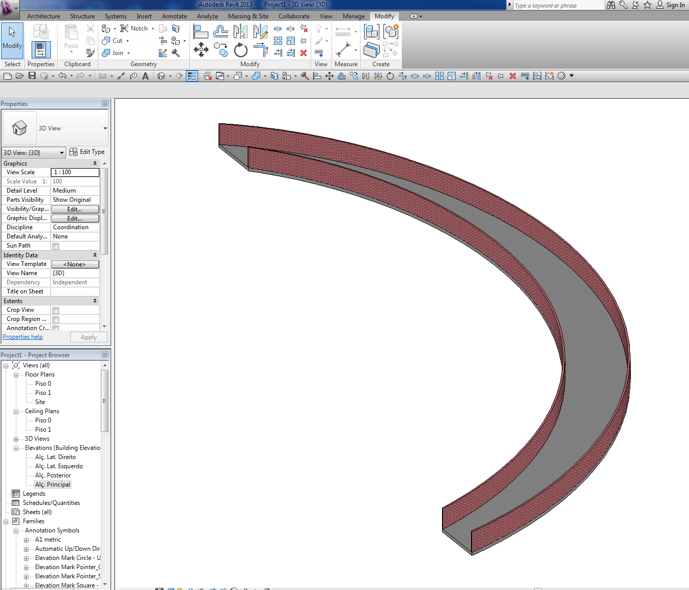

There are several methods. One method is this: create the ramp, then do Model In-place, using the Sweep tool > Sketch path > Pick 3d Edges > select the curve of the ramp. Select profile > edit profile > draw the section of the wall. Finish sweep, finish solid.
