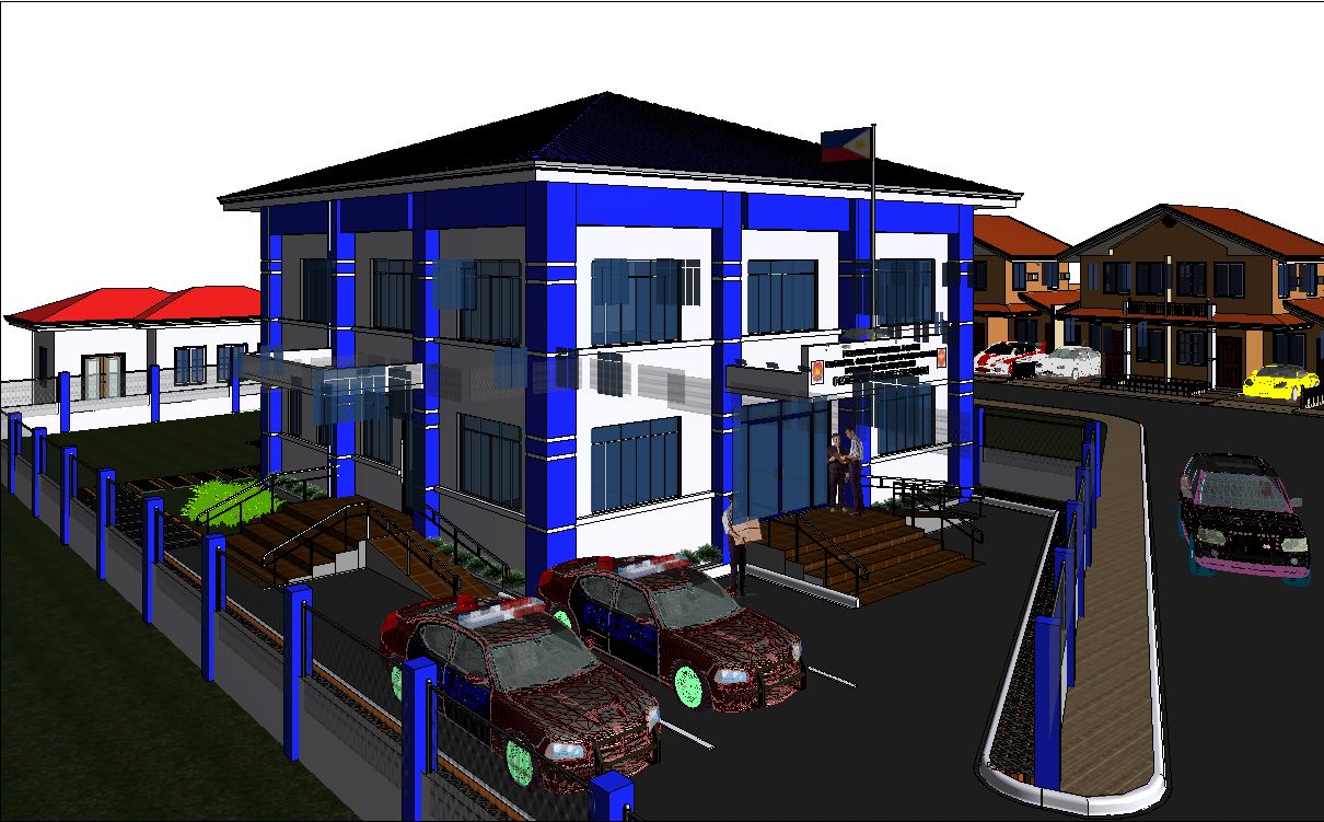

I would like to ask your help on how to eliminate this annoying glass reflections in 3D or Camera view (either using Consistent Colors or Reliastic setting). Attached is a j.peg drawing sample.

That's a "Graphic Card" issue, try to UPDATE your GRAPH. DRIVERS, that will solve the problem...

Typhoon, thanks so much for your advise, it works!!! Now I can work my design without the annoying glass reflections.
