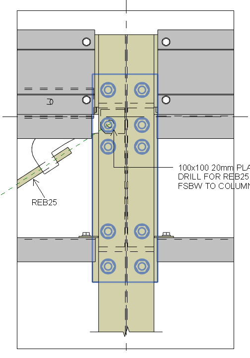

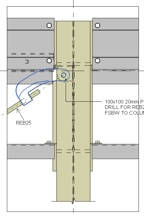

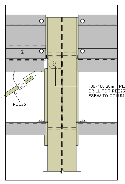

Here are some screen shots from a 2d detail, if I select the conneciton it shows through in blue, I want these lines to show as hidden lines and not be completely blocked out by objects in front. In the image "manually drawn cleat" I have traced around the bracing cleat to show how I would like to see the rest of the lines/bolts that are hidden.
If something in the model changes I do not want to have to redraw and move manually drawn lines in details and if the connections are already modeled why would I want to draw over them again manually? There must be a way to show these lines....

The only thing that I can think of would be to set the visual style to wireframe and use the linework tool to change the linetypes to what you want.

Hi, I managed to get it to work by changing the in-place category to generic model instead of structural connections now the show hidden line tool works for the in-place component. Thanks for your contributions.
