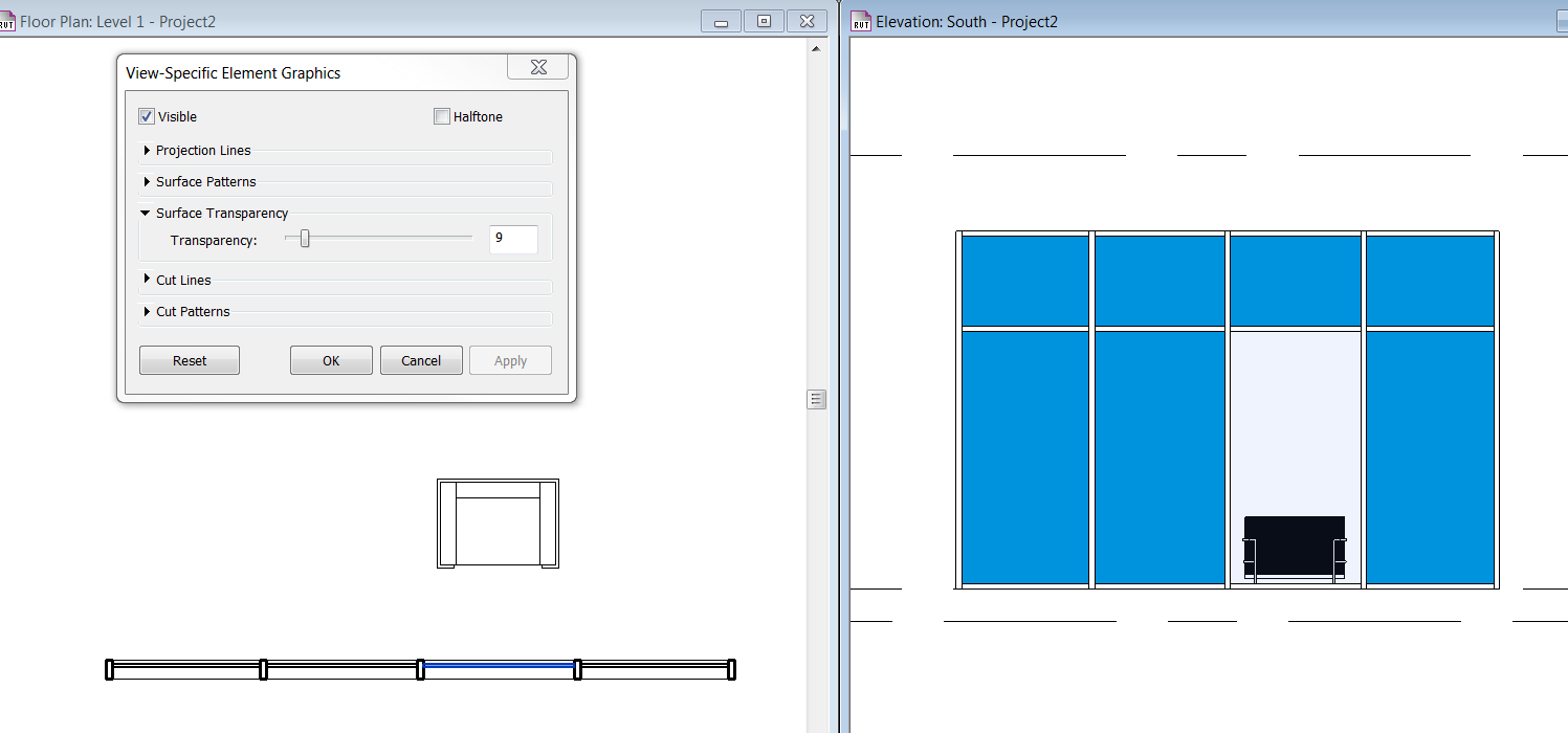

i need to show my glass curtain wall system as "real glass" in shaded with shadows elevation views. PLEASE dont tell me to use 3d
views instead and orient it to the neeeded elevation. because i need the level bubbles and grid bubbles shown which is not possible
in 3d views. thanks in advance.

what i mean is transparent glass. see through glass in shaded (colored) elevations.

I just use the graphical 'override by element' and add surface transparency to either the one panel, all the panels or the entire category. So yes, it's do-able.
