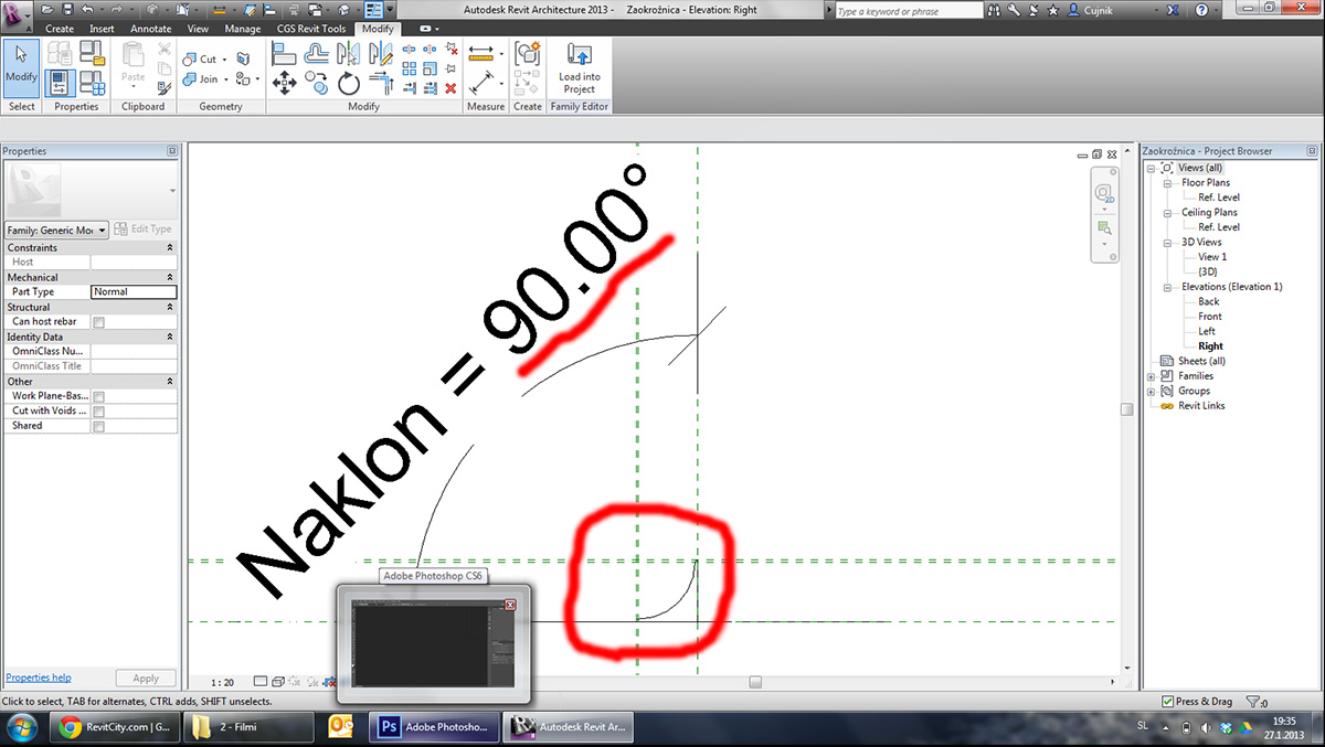

I need a sweep on it, from first last panel, so I made a line based sweep.
And this sweeps are sometimes at the bottom of wall and sometimes at the top of the wall/panel.
What's the problem? Angle of this sweep, when I put it on, is 0˙, 90˙, 180 ˙ and 270˙.
But I can't make a parameter angle at this family. Always I have just 0˙ and 180˙ angle.
So my question is how to make a parameter angle, that I can put just one family into project and select diferent type for angle.

So, on the picture, you see a sweep on 90˙ angle, and I want to have one family for 4 different angles, just 4 types in one family.
And I don't know how to do this. When I put a parameter angle, I can't change it.
It's done in Generic line based template.
