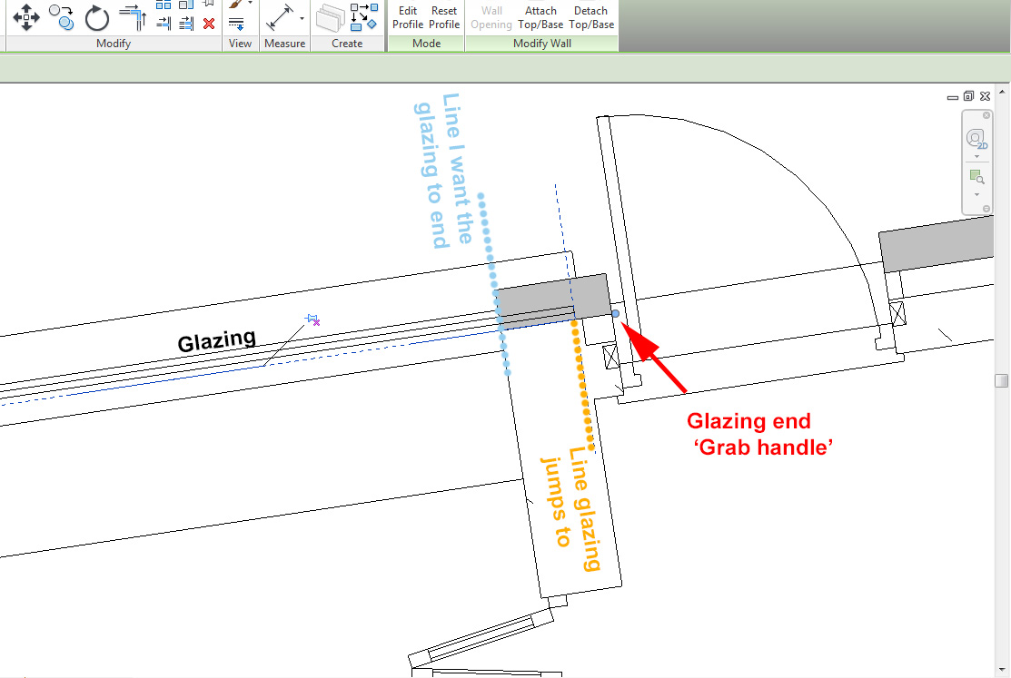

I'm struggling with something which I have tried to explain in the attached image. I have an element of glazing sitting on a plinth which connects into a wall. The problem being that the glazing is not sitting flush with the wall it meets. The orange line representing where the glazing wants to finish instead. In the diagram if I drag the 'grab handle for the glazing to the blue line (where I want it to sit) then it just jumps back to the same position. I seem to come across a few instances like this, is there something funamental that I am doing wrong? Some setting I'm not ticking?
Thanks for any replies.
Simon

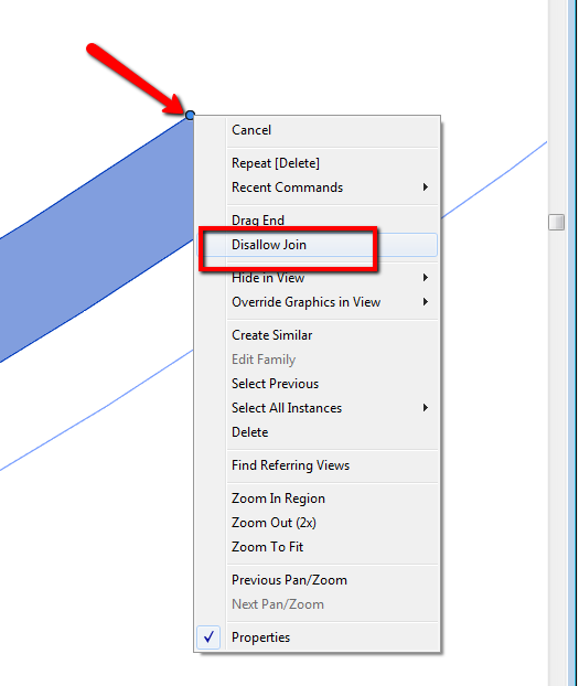

Thu, Jan 24, 2013 at 9:59:16 AM | Problem with glazing and wall alignments
Joined: Tue, May 22, 2007
5921 Posts
4 Stars: 205 Votes
If this is what i'm thinking the problem is in the wall, try to "Disallow Join" then drag BUT I believe you don't have wall enough to do that...
Thu, Jan 24, 2013 at 10:07:07 AM | Problem with glazing and wall alignments
MEBDesign
Joined: Thu, Jun 9, 2011
45 Posts
It wouldn't allow me to move it directly to the position I wanted but would on the second move of the handle. So that is sorted now thanks, what is the 'disallow join' option actaully doing?
Thu, Jan 24, 2013 at 10:10:46 AM | Problem with glazing and wall alignments
5921 Posts
4 Stars: 205 Votes
From your HELP menu: http://wikihelp.autodesk.com/Revit/enu/2013/Help/00001-Revit_He0/0328-Build_th328/0330-Architec330/0331-Walls331/0336-Modifyin336/0339-Wall_Joi339/0346-Allowing346
Thu, Jan 24, 2013 at 10:16:59 AM | Problem with glazing and wall alignments
MEBDesign
45 Posts
My bad, should have checked that, thanks though!
