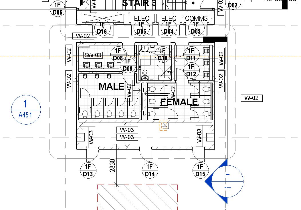

Hi everyone, I'm facing a problem that I'd like to find a solution without major workarounds.
I'm doing a commercial building where the core is a group placed on 4 out of the 5 floors. I know the only parameter I can change on grouped doors is the mark, nothing else, right?
My door tag shows the floor (1F, 2F, 3F, etc.) and the door number, both using the same parameter: Mark. I've also got a callout to one of the typical cores for detailing but on this callout instead of showing the floor and the door number I want to show TF (for Typical Floor) and the door number.
I'd like to keep my floor information (1F, 2F, 3F, etc.) for schedule purposes and use another parameter to display the TF but I don't see a way to not show the floor and still show the door number since I can't split these two into two separate ones.
Any help is greatly appreciated.

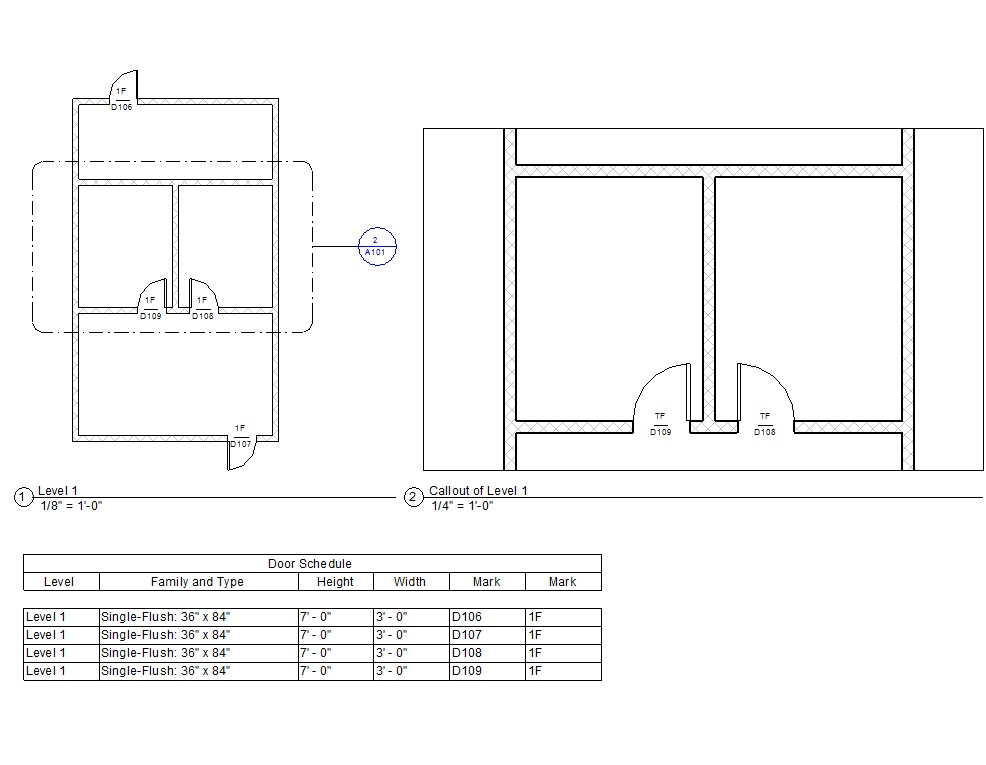

Mon, Jan 21, 2013 at 4:41:34 AM | Tagging & Scheduling grouped doors
Pavan
Pavan Avatar
Joined: Sat, Mar 19, 2005
157 Posts
4.5 Stars: 3 Votes
Create a new door tag with a new 'Mark' shared parameter and use this tag in your enlarge plan.

Mon, Jan 21, 2013 at 11:13:23 AM | Tagging & Scheduling grouped doors
CDWdavid
Joined: Mon, Aug 4, 2008
153 Posts
5 Stars: 5 Votes
Thanks Pavan,
That's a perfect solution.
I'll try it in the future.
Mon, Jan 21, 2013 at 11:26:00 AM | Tagging & Scheduling grouped doors
#9
Be aware that this new tag will not work the same in schedules..... The regular tag will be in a different column.
