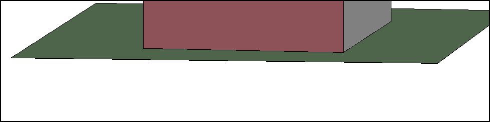

I have a problem that I have spent many hours trying to solve but with no success. I am on Revit 2011 Arch.
1. When I create a Toposurface it does not show the depth in the 3D model.
- I have adjust the poche value accrodingly and it shows/displays fine in elevation view.
- I have checked that nothing obvious is hidden. All graphic settings seem OK.
- Section boxing the 3D view work fine but still no depth in Topo, its like a thin layer.

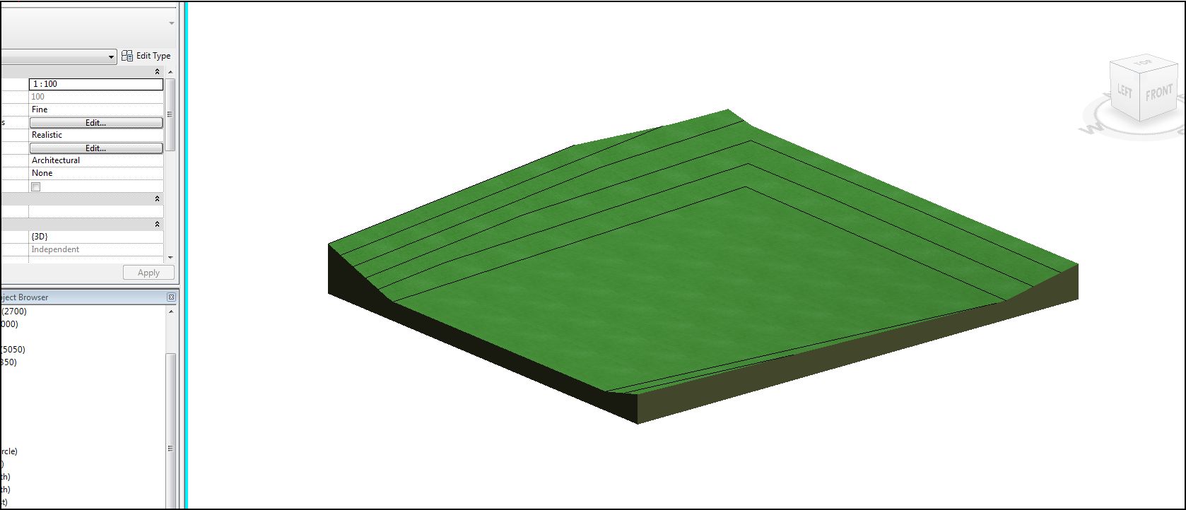

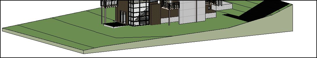

Here's some images to show you what I am getting and what I would like to do....
Any help would be great, Thanks.

Make sure your topography extends beyond what you want to show, then create a section box to the limits of what you want and turn that on in your 3d view.

Ok thanks, tried to follow what you said but nope nothing works.

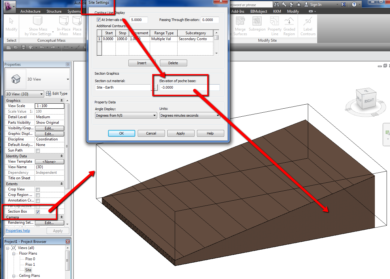

After trying a few more times with your advise, I have figured it out now. :-)
Its basically I mixture of crop view, poche and section box settings.
