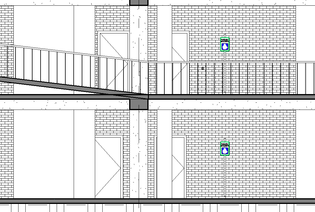

Hi everybody!
I'm a beginner in Revit and I don't know how to joint the Ramp and floor or beam. Where have i gone wrong? Is there a solution to that?
Please advice
Wed, Jan 16, 2013 at 9:15:47 AM | Joint between Ramp and floor ( or beam )
sllana
Joined: Wed, Mar 2, 2011
106 Posts
5 Stars: 2 Votes
Im afraid u can not. I suggest u to make a floor with slope arrow to achieve the ramp (must add the railings manualy) so u can do the join
