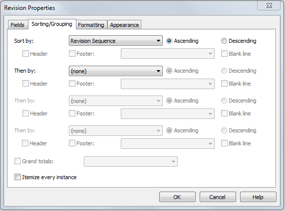

The order is there for you to set:

Yes, thank you.
But because of a sub contractor I had to change that to Revision Date and in ascending order.  Now when I add this year's revisions, they are showing up at the bottom.  Revit is seeing 1 (January) as coming before November (11), even though it's 1/2013, not 1/2012.
