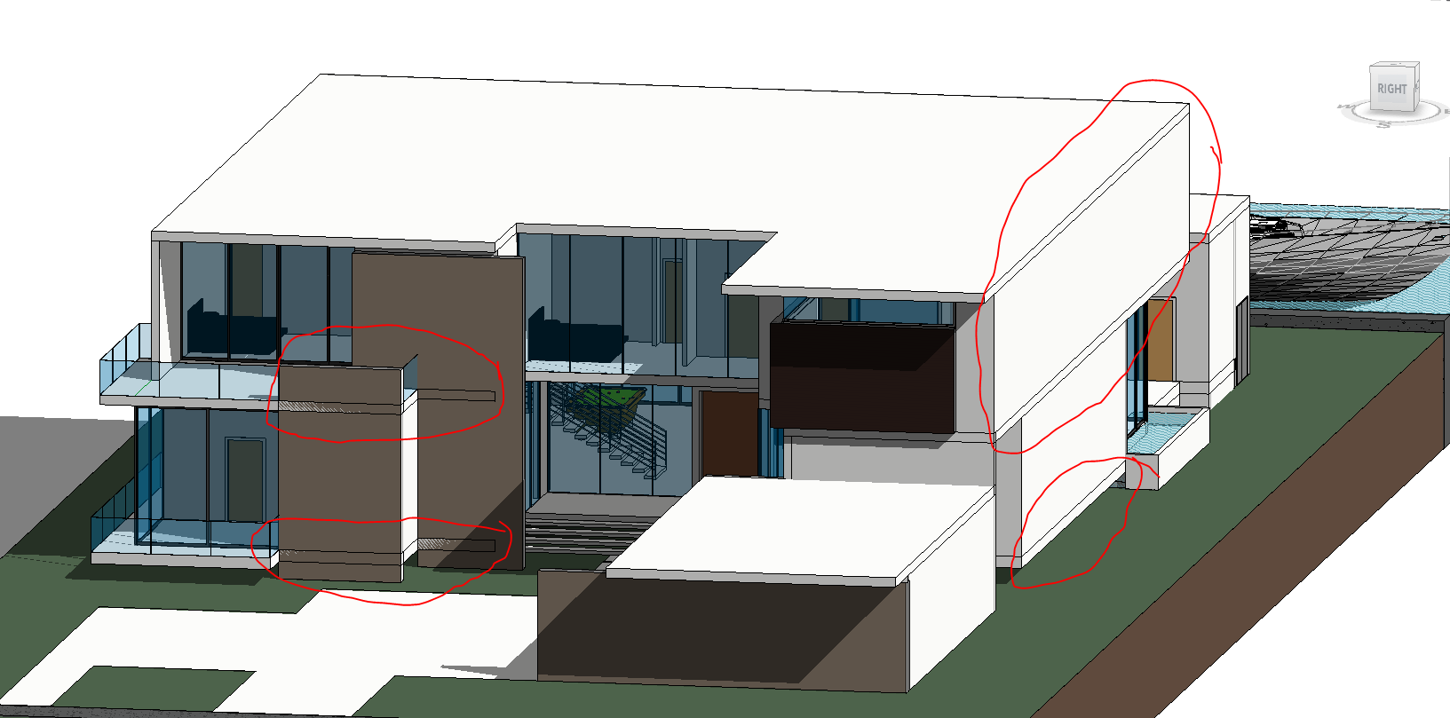

Hello,
I am trying to find a solution to the floor edges that are showing through the walls in my Revit house.  I attached a picture.  Even when I render, for example, the white floors show through the brown stone.  HELP PLEASE!
Thanks
Fri, Jan 11, 2013 at 2:23:39 PM | HIDING FLOOR EDGES ON WALLS
Build the model like you would build the house.  If the floor doesn't go to the ouside face of the wall then edit the floor sketch accordingly.

Try to join the wall and floor together.
Tue, Jan 15, 2013 at 9:58:15 AM | HIDING FLOOR EDGES ON WALLS
jmagruder

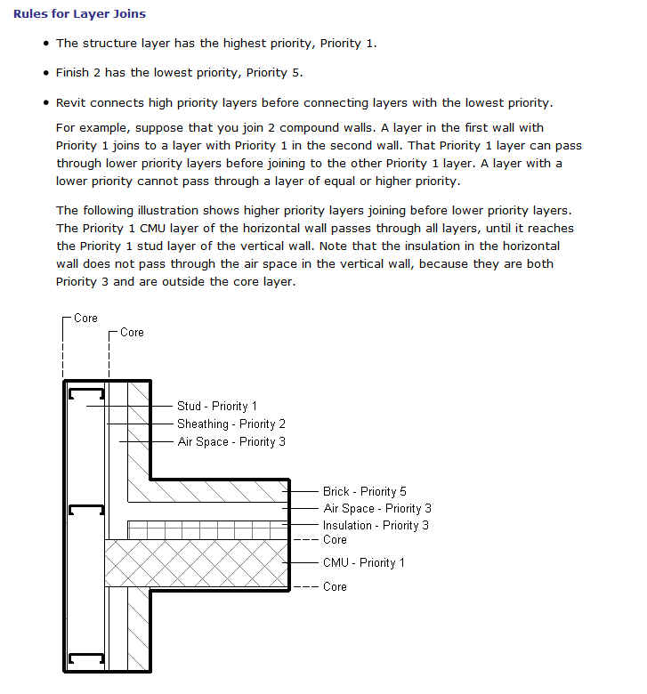

Just joining will not work here.  Read "
Applying a Function to a Layer of a Compound Structure" in your HELP
