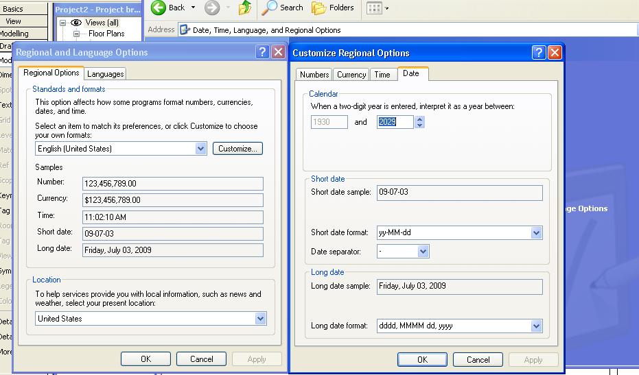

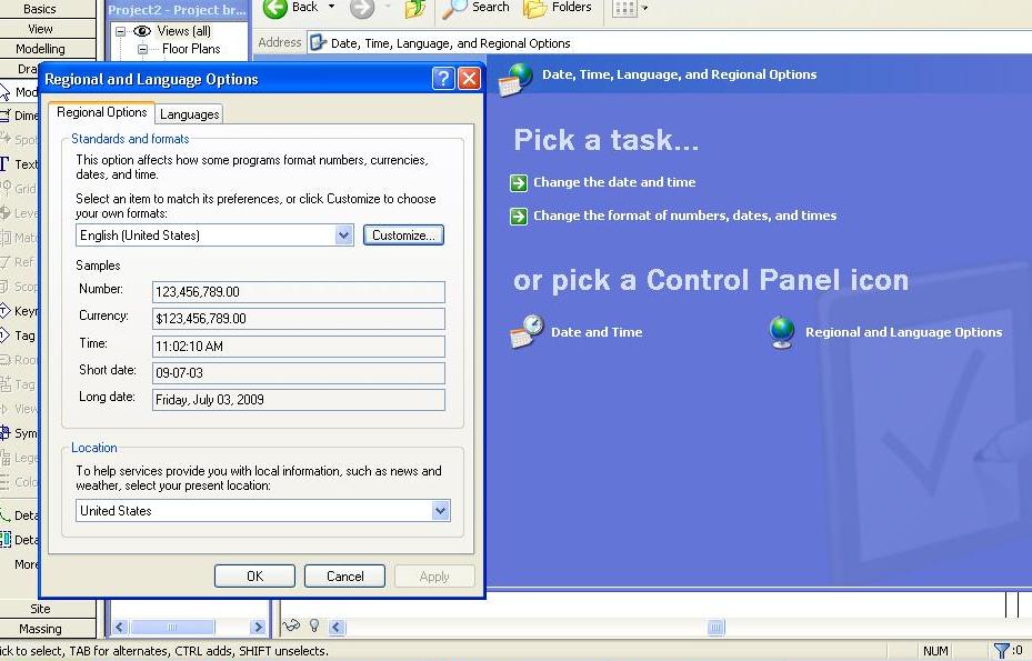

Simple...If your using XP then Click on Start>Control Panel, then Double click on Date and Time and then click on Change the format of nuber, date and time, then click on customize then click on date tab and select yy-MM-dd (or type) your own format. Then on time tab type h:m for time format field. Now you can have your format of date like 09-07-02 10:30. Here you can't eliminate time but you can eliminate seconds. See attched images.

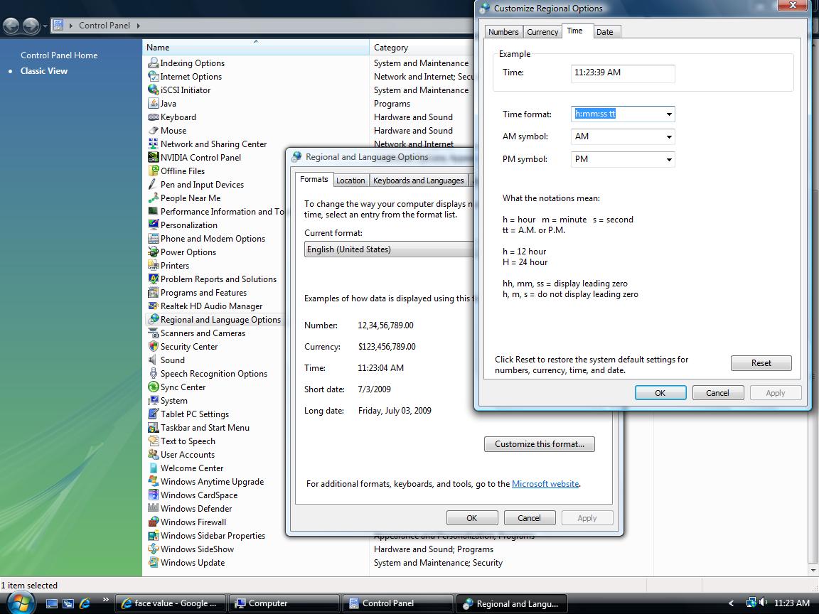

For Vista users Open Control panel, double click on Regional and language options and click on customize this format and change the date and time as you like. Check the attachment

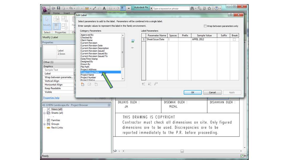

@erichgw:
"We just started using Revit Architecture 2011 and I've been charged with setting up our title blocks.  In the past, we've had problems with the dates on our sheets being updated prior to printing a set so this time around, we want to set up a "date plotted" field and have Revit automatically insert the current date.  I know that there is a default "date/time" label available, but we don't want the time to show up in our title block - just the date.  I've been searching this forum and it seems like others have been looking for a similar solution but I haven't been able to find the answer.  Has anyone been able to solve this problem?  Thanks!"
Instead of using "Date/Time Stamp",use "Project Issue Date". Then you may change on the Sample Value or also you too can change it later in any Sheet openedWinking
