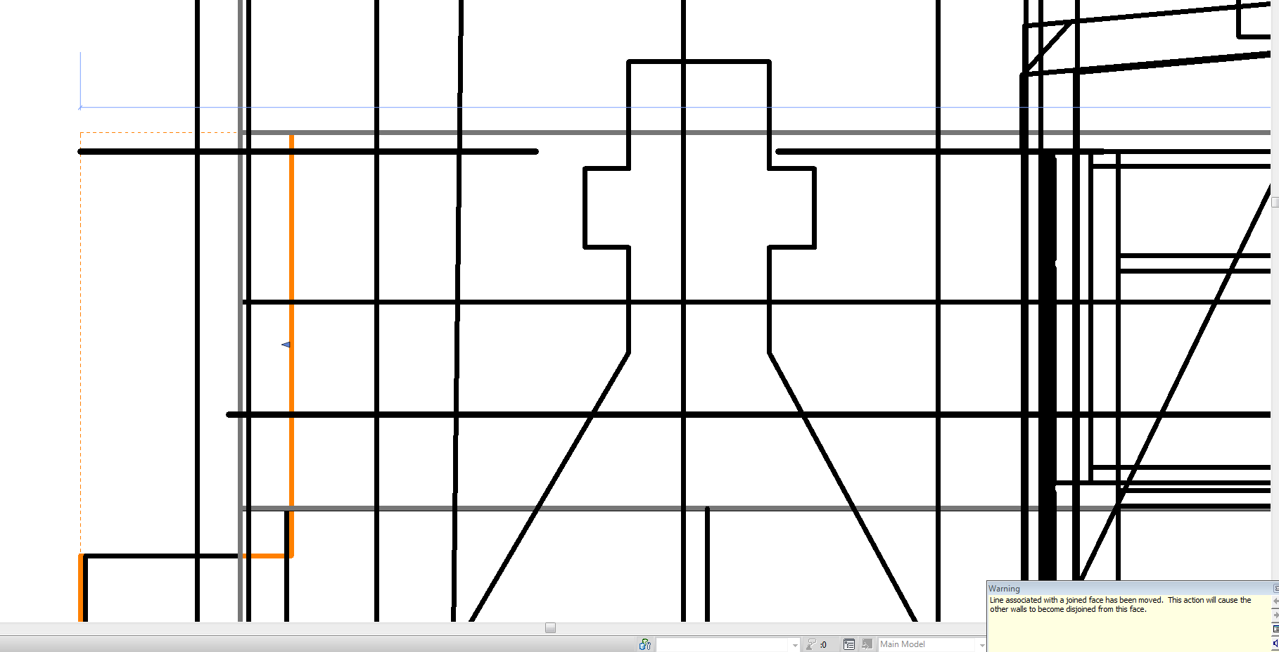

I´m trying to edit a walls profile. When i try to move one patricular line and press finnish editing the line moves and this warning comes up:
Fri, Jan 11, 2013 at 8:37:40 AM | Please explain warning
It means exactly what it says.  You are affecting how this wall you are editing is joined to another object.  It can't join if it isn't there!

How do i know what its joined to and unjoin them? I don´t want the wall to be joined to another object. I just want to edit the wall the way i like..
Fri, Jan 11, 2013 at 9:11:13 AM | Please explain warning
"... I don´t want the wall to be joined to another object...."  Seems pretty objious -  Then just ignore the warning!
Expand the warning if you want to see what was affected.

The problem is that i can ignore the warning. The line i try to move just moves back to its original position.

Unjoin the walls before making you wall profile change.
