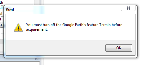

I get this error when trying to use the Autodesk Globe Link plug-in.
I have seen older posts about it - but no solution
Running Revit 2013
Downloaded Google Earth today.
Thanks!

Open your Google Earth, go to Tools/Options and on the 3D View tab turn off Terrain.
