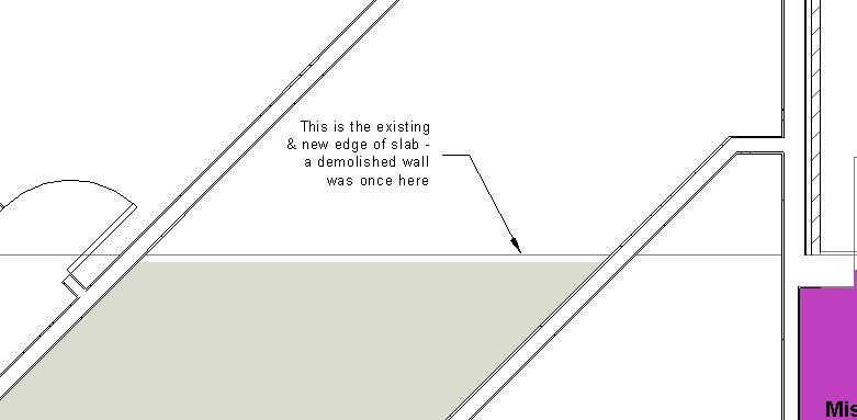

Hi WW,
I'm having a similar problem. Revit wants to constrain the room to demolished walls. See the attached image. No hidden elements are at this location. We've even tried deleting the slabs (existing and new), but that didn't work either. Any ideas?
Mon, Feb 3, 2014 at 7:25:05 AM | ROOM TAG TAGS ONLY HALF OF THE ROOM
Turn off room bounding for that demolished wall.
