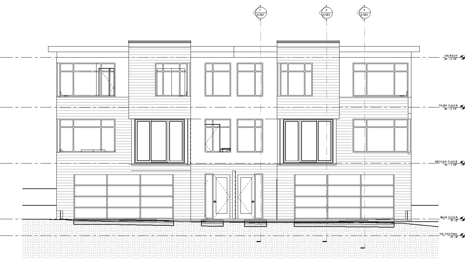

I have an overhead rolling door that refuses to be opaque. I've gone into the family editor, neither transparency option for the opening is checked. The visual styles aren't checked to be transparent. Any other ideas? Other doors are displaying properly, just this group of doors.
This is in Revit 2012.

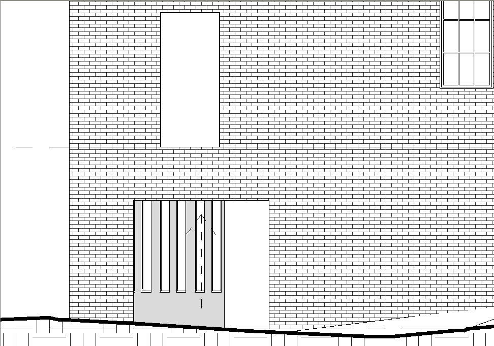

All the doors were showing properly when I started this morning. I made some adjustments to the walls, now these doors don't show in elevation, but do in 3D. Also, the regular, stock single flush doors aren't displaying their door swings in elevation. I don't know if that's related at all.

Ok.. after coming back to it today, it turns out that making a new elevation didn't actually work. If I adjust the far clip plane, the doors disappear again. I think I can adjust the individual views to make it look correct, but I'm curious if there is any fix for it?
Fri, Jan 11, 2013 at 8:35:36 AM | Door is Transparent, but no transparency options are checked
#11
Fix what?
Obviously this family doesn't like where you are setting the far clipping plane.  Look at your far clipping plane in plan view and you may see what your problem is.  Post the image showing that if you don't.

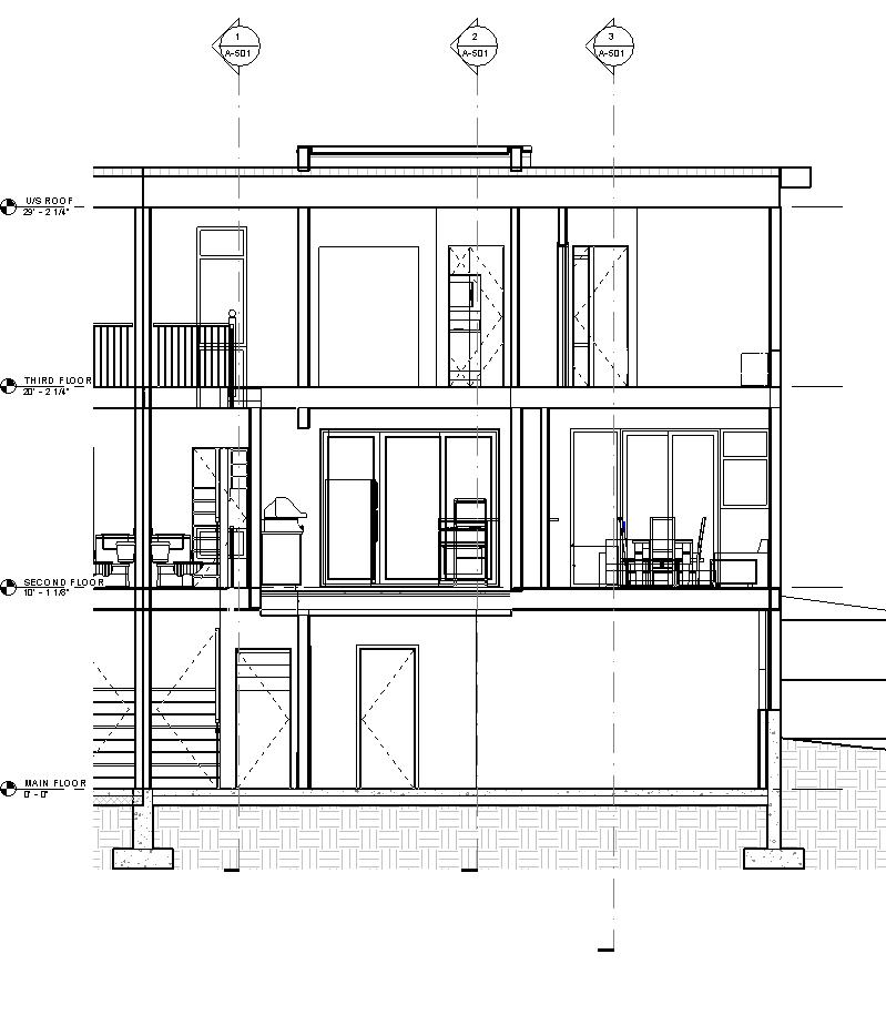

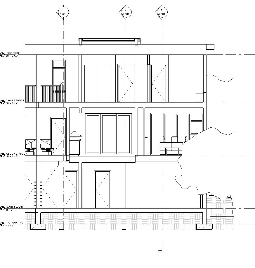

I too just noticed the same problem in a small project. my issue pertains to transparent door slabs and glass panes in section/elevation views.
also, in sections i have  "objects behind other objects" mask the "other objects as if the behind objects we infront"
very strange,.  it would appear that the only thing to do it copy paste your model elements into a clean file then test.

solved
reset / use a different "default View Template".
turns out i had a variant of the floor plan view template copied and renamed as my section view template.
problem solved
