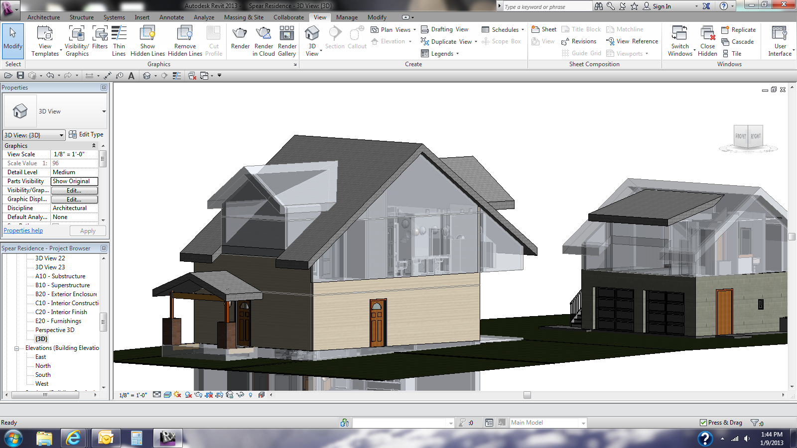

For some reason the walls on my second story are see-through. I'm using Revit 2013. I have checked the properties and everything seems to be set the same as the walls on the first floor. Any help is appreciated. I have attached pictures.

Update your "Graphic card drivers", also try to turned off "Hardware Acceleration" in your "Options"
