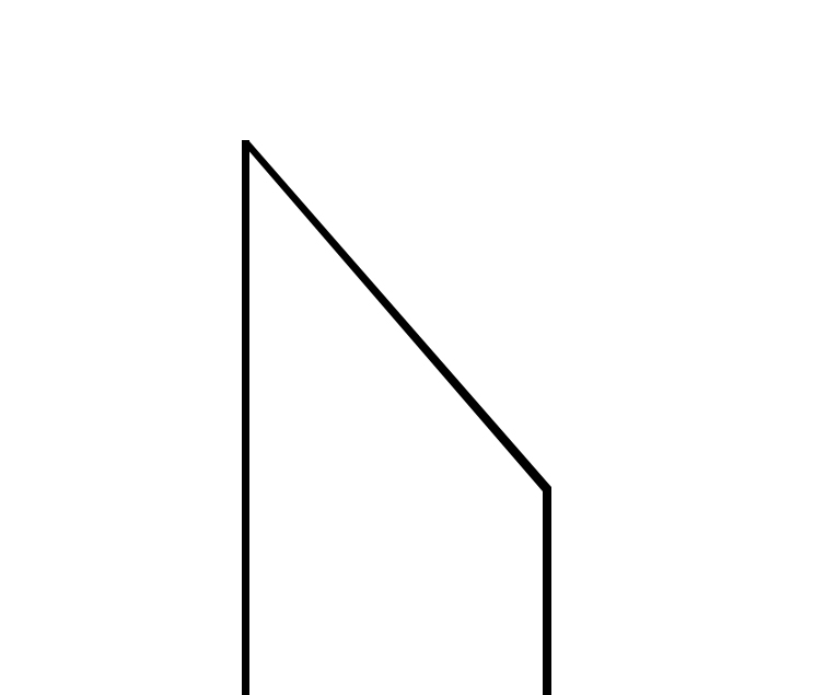

Hi, im working in Revit Architecture 2013.
I need to build walls with edged walls. (see attached bitmap)
What is the best way to get this wall?
Thanks.
D

What is the purpose of these walls, are there only a few?  You can model in-place walls or use voids to cut the end condition.

Just a question: Is that image in "Plan view"or "Section/elevation" view?

Good question Ty, I was assuming plan view!

Sorry, i should of course have told what view the image was. It is in plan view.
Thanx teafoe5, i will try your suggestion.
