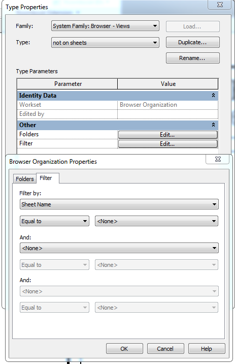

How do you make sure that when you place your views onto a drawing sheet they no longer appear within the floor plan drop down?
Thanks
Fri, Jan 4, 2013 at 10:15:07 AM | VIEWS TO BE FIXED TO DRAWING SHEETS
The browser organization is up to you.  Right click on the "Views.... " at the top of the browser.  You can set up your own Types.  The image below is our "NOT ON SHEETS" organization.  You want one that is opposite.

cheers thats great
