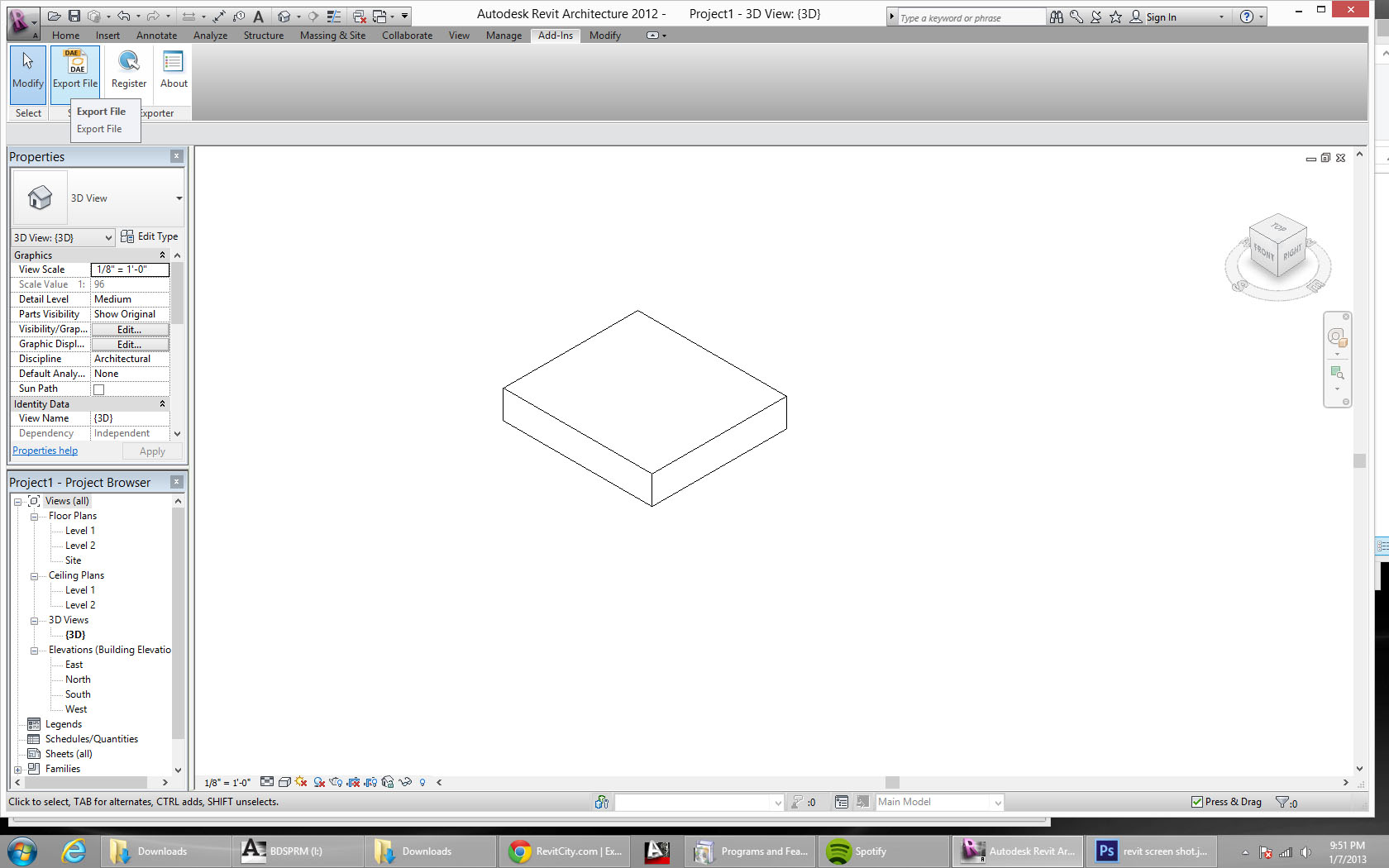

I am trying to figure out how to export my Revit model to Lumion so I can edit the materials when i bring the model in.  I have tried exporting the revit model to .FBX but when i bring it into Lumion, it all reads as one mass and if I change the material of it, it changes everything.

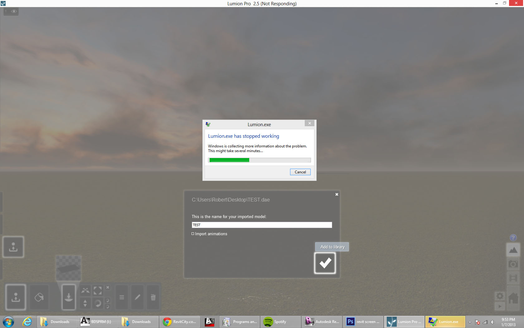

I downloaded the collada exporter (not thru Lumion because it didnt allow me) but everytime i try to import it into Lumion, it says "lumion has stopped working".  The file is a .DAE file that it saves it to.  Any thoughts?

You have to use the "Collada Exporter" from "Lumion"
